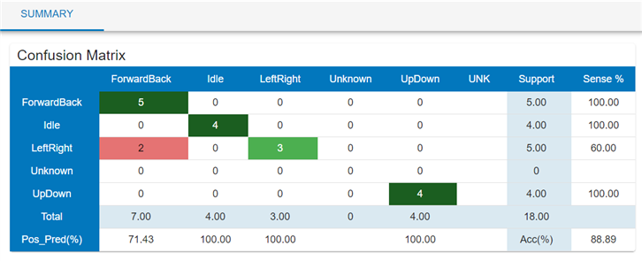

I had suggested in my previous post that I thought the poor performance of my model was due to trying to classify multiple items within a single data sample which might be sensitive to the size and movement of the classification window across the data sample.
Here are is the Confusion Matrix from those tests:
It seemed like a simple test would be to produce test data samples that only contained a single class within each sample.
I captured two 5 second data samples of each class and retested the model.  The results really surprised me.  The overall accuracy improved, but now the LeftRight class has issues.
After a quick look at the data, I realized what is probably causing the problem.  When I generated the training data, I did a poor job of isolating the 3 movement axes.  My intent was to have each class represent movement along a single axis.
Here's a representative training sample that captures sequentially Z(UpDown), Y(LeftRight), and X(ForwardBack):
You can see that I didn't do a great job of isolating the axes.  The LeftRight is the worst.  I think that I had the board slightly rotated around the X axis and picked up movement on the Z axis.  I was pretty consistent yesterday, so I think the model trained with consistently "bad" data.
I was a little more careful when I took the test data today and that seems to have caused a data mismatch.  This is probably just a case of having insufficient training data.  I should have data that has "some" skew in the other axes for training.  The model has probably overfit the data.
