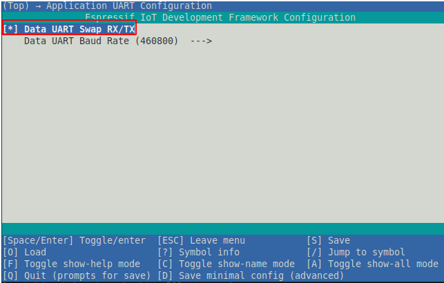

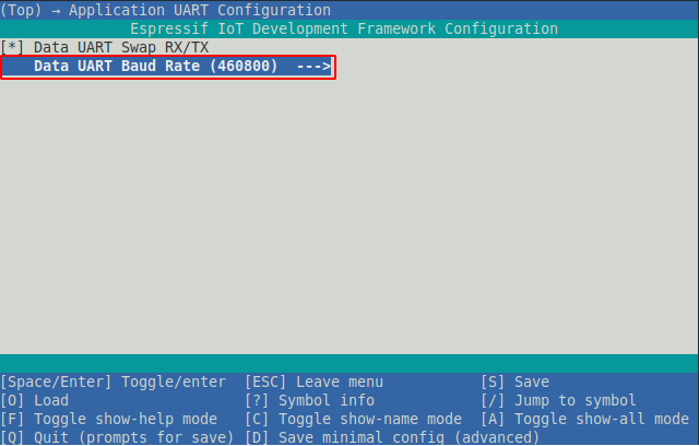

Then run the command idf.py menuconfig which will bring up a GUI that allows configuration of the WiFi and UART parameters.
All commands are run in the Windows CMD window.
Swap the RX/TX pins if using stacked boards.
Normally data rate is set to 921600 if using the primary serial port and reduced to 460800 if using a secondary port.
