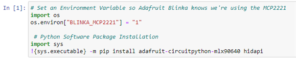

There is a requirement that the Adafruit Blinka CircuitPython library compatibility layer is installed in your environment.  You can do that using another Jupyter Notebook MCP2221_Test.ipynb that will also check your MCP2221 installation.

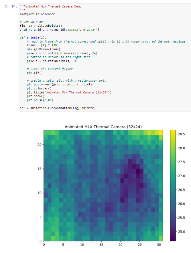

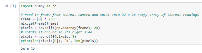

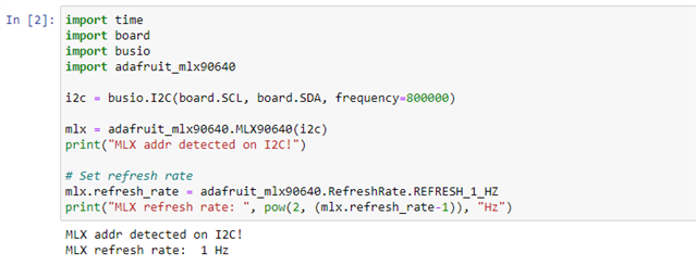

Running the camera from the notebook is straightforward:
Setup environment and install requirements
Import libraries and connect to camera

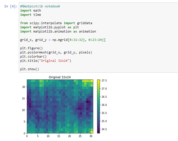

Read frame from camera into numpy array
Plot the array
And finally run a continuous animation of frames from camera
Demo of thermal image of me sitting in front of camera.  I noticed that when I put my hand up that it isn't very warm compared to my face.  I have Raynaud's disease (essentially poor circulation in extremities - hands and feet), so maybe this could be used diagnostically...
