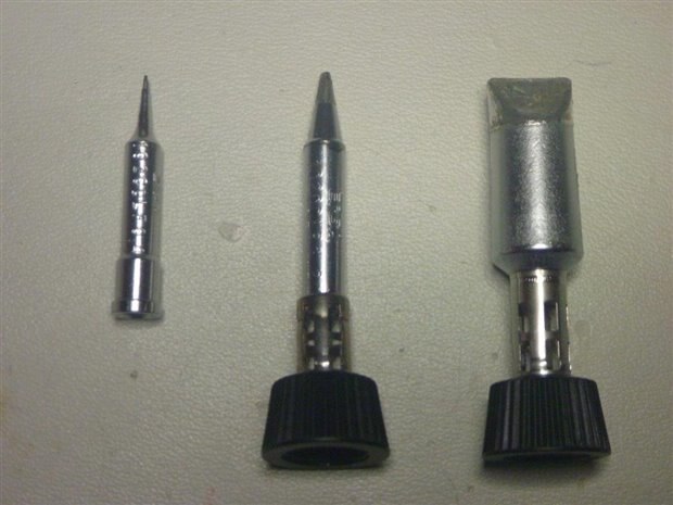

This is a good opportunity to use my 10mm soldering iron tip. My set of iron tips ranges from 0.4mm to 10mm. Here are a few pictures of them.
0.4mm, 1.2mm, 10mm tips.

For this job, it is obvious that the 0.4mm tip is far too small and the 10mm tip is perfect for the job.
I use chisel tips as this provides sufficient surface area for the heat transfer.

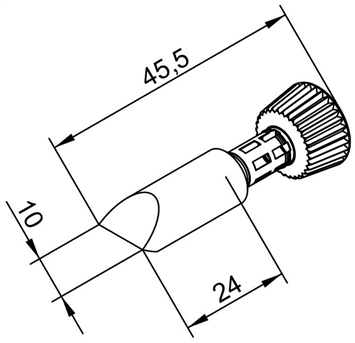

I used my 150W (Yes 150W!) ERSA iCON 1 soldering iron (Order Code 162358) to solder the battery holder.
This iron monitors tip temperature and adjusts the tip temperature as necessary whether it requires more or less.

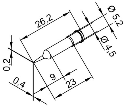

This picture is from the online catalogue. Don't use the temperature as indicated on this diagram on your XL_STAR unless you want to risk damaging it!!
