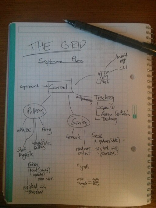

With this in mind we laid out a plan for our core software.
If you'd like to follow along at home, all the code we've written is on GitHub at https://github.com/cillian64/thegrid/tree/master/control/thegrid.
Core Control Software
`control.py` implements the core of the software, which is responsible for shuttling data between the "Patterns" (these decide which lights to turn on and when) and the "Sinks" (which act on that data, for example displaying a virtual Grid). It additionally exposes a control and information API over HTTP. The core contains the software entry point -- this is where execution really starts. When initialised, it starts the HTTP API and the tracking subsystem, loads any default sinks that have been configured in the settings file, and moves into the main loop.
In the main loop we check for any commands coming in from the HTTP API (`api.py`) and deal with them appropriately, for example by loading a new Pattern module or unloading a Sink. The currently loaded Pattern is executed to get the new display frame (i.e., which lights should be on or off) and this is sent to all active Sinks for outputting (You can have multiple Sinks loaded at the same time, for example driving the real grid alongside a debug display). The main loop then goes to sleep until it's time to display the next frame.
The HTTP API is designed to allow other scripts or remote controls (for example an Android app for selecting patterns) to control the system running The Grid without needing physical access to the control PC. In the end we implemented three functions in the API: you could use it to load a new Pattern (replacing the previous pattern) or load or unload a Sink. We chose HTTP because it's easy to work with from any number of other clients, and very simple to get running in side Python using the fantastic Flask library.

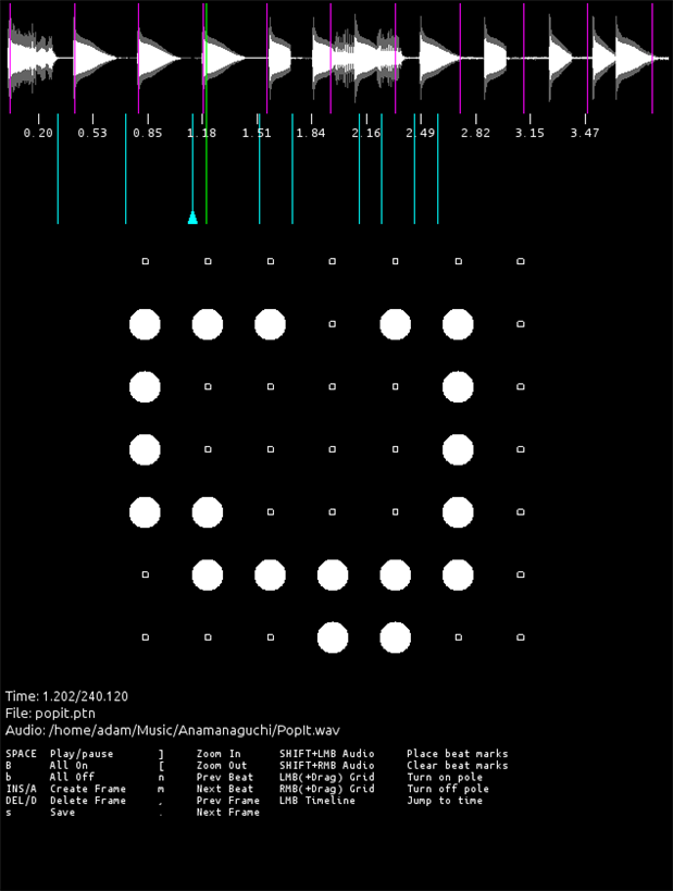

We wanted to try patterns synchronised to music. We created a desktop app (also in Python) which allowed users to draw frames against a music timeline, with functions like snapping to the beat and repeating sections. This app could save out the pattern data, and we wrote a MusicPattern class that could load these files and play back the appropriate MP3 file at the same time as displaying the patterns.
Unfortunately creating these patterns still proved very labour intensive so we didn't have any good ones ready in time for EMF 2014. Hopefully next time!

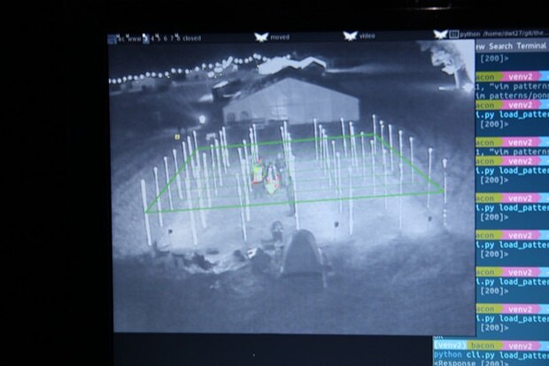

The basic concept of this system was to have a camera watching the whole Grid and attempt to detect where people were in its field of view, and therefore locate them in Grid coordinates. Since The Grid is a very difficult environment to work in (dark, with rapidly changing bright light sources, and fast-moving people) we knew we were in for a challenge. We made sure our camera could see into the infra-red spectrum (lots of cheap CCTV cameras can do this!), which allowed us to illuminate The Grid with IR floodlights that are invisible to the human eye. We designed the poles so that as few LEDs as possible would be pointed directly towards the camera, which helped prevent blinding it. We even tried using an IR filter on the camera, but in the end it caused more problems than it solved -- we couldn't mount it properly on the camera, and got quite a lot of internal reflections between the camera glass and lens.
Once the camera is capturing images that are as good as we can make them, we have to detect people in those images. The first hope was to use a trained machine learning approach, which would recognise people-shaped outlines in the image. However not only does this require a lot of computational resources, but it turned out to be quite hard to recognise people from a high elevation in the dark. Instead we went with a second approach, where we filtered the images to detect motion, and then tagged areas of motion that were large enough and moving fast enough to be likely a person rather than Grid poles swaying in the breeze or random noise. By tracking these moving areas over time, and only accepting areas that were consistently large enough, we could eliminate many more false positives. Then we find the centroid of each moving area, which tells us where (in the camera's field of view) the person is. Combining this with the position of the four edges of The Grid, we can use a projection to find the person's location on the flat plane of The Grid itself.  The code to do this is in cv.py.
This display shows a green plane at roughly chest-height, which is where we predict most people's centroids to be. Detected movement areas, after being grouped together, are filtered based on size, aspect ratio and location to remove the false positives (the red and yellow markers). After a point has been tracked for more than a few frames inside The Grid area we declare it a human centroid (the green box) and continue to track its movements through the grid.

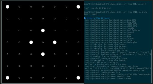

The Sinks (in the `sinks/` directory) are responsible for using patterns' output data to do something useful. We ended up with a number of sinks - some would display the pattern on the computer screen (console.py and tkinter.py), useful for debugging and testing, and others wrote data to hardware in various ways (ftdi.py and leonardo.py).
Prototyping
The first Sink we created just printed a representation of the current grid status to the console, which was very simple but reasonably effective. A later upgrade added cursor control codes so we didn't spam the console quite so much. To improve matters we wrote a version with a graphical interface using Tkinter.
