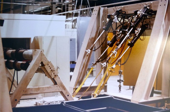

    Learning can be scary
    I tend to erase traumatic experiences from my memory, but horror stories that happened to other people - no problem. Anyway this one happened to me: I was working on load cells on a vehicle test stand which measured forces required to break seat belts and seats. The system ran on hydraulics at 1750 psi. The hydraulic pistons in the picture could exert over 5,000 pounds of force. The 30 liter system accumulator was mounted behind the lower I-beam that the actuators were mounted to. The yellow belts were used to test the system before destroying a car. I was well aware of the energy in the system and the violence it was capable of, but there were lots of safety systems.
    I was working on the cables on the pistons, when the fitting on the end of the accumulator popped off. Fortunately the fitting stayed attached to the hose but the oil in the accumulator shot out like a steel bar and hit the control room 40 feet to the left. Maximum pressure in a fire hose is about 290 psi, so you can imagine oil coming out a 1 inch nozzle at 1700 psi. Gravity had no time to act - the oil hit the wall at the same height as the accumulator. I dutifully trotted off the platform to a safe distance. When I say trotted I mean I could give lessons to the Flash in how to move quickly. If the other end of the hose had let go I would have been in much more serious trouble, possibly receiving a highly toxic oil transfusion. When the oil hit the wall it sprayed high in the air and covered the whole area with oil rain. Some of the ceiling tiles in the control room had been removed to improve air circulation, so several racks of equipment in there got coated with oil. Pretty tough to pass off the incident as "we spilled a little oil". We did alter our safety precautions after the incident. Sometimes it is fun to learn, sometimes it is just imperative.
