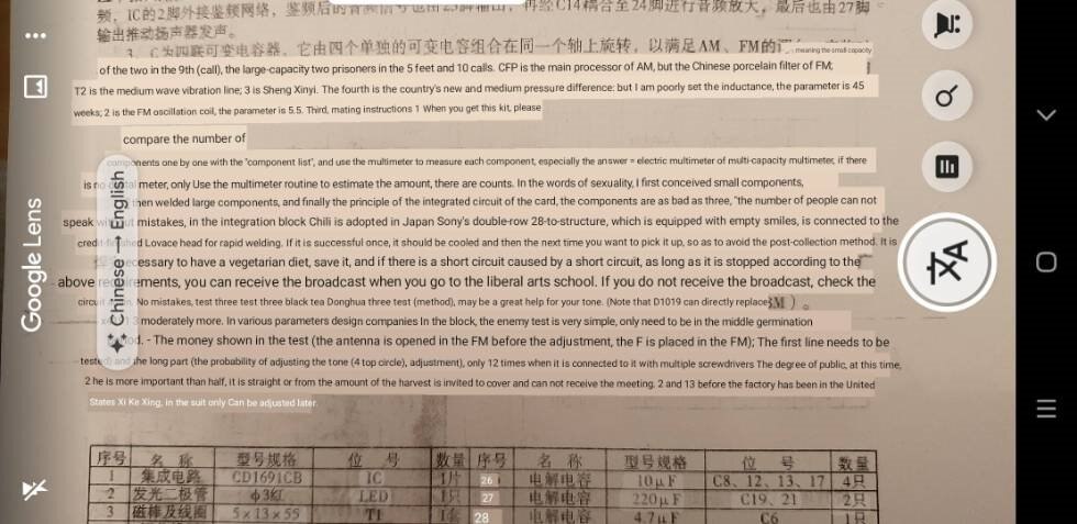

The ZX2051 is a low-cost kit to build an AM/FM radio receiver. I thought it could be fun for kids to assemble. The instructions are in Chinese, so the purpose of this blog post was to document any information needed in English (or other languages) to successfully build it.
Any translations, or advice, is welcome, since I cannot do this entirely on my own : )
Original Documentation
Since I don't have the copyright to it, I've saved high-res scans of the ZX2051 documentation on a third party server during the time that collaboration is needed, but will remove the link after it is no longer required to act as the only documentation.
There are low-res copies of it here (might not be readable), which I believe is fair use.
Translation Attempt #1
Google Lens was attempted, with some success and some amusement. It didn't get the translation entirely right I think : )
Another attempt was only slightly better:
One more time..
