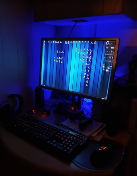

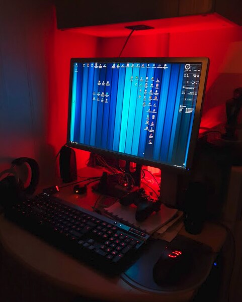

I nearly bought this kind of thing, but then realised I had all the parts I needed to make it myself, which is half the fun, right?! image
This video shows it in action;
What I'm using in this build is;

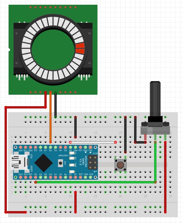

PartApprox Price
24 LED Ring£2
Arduino Nano£1.75
Breadboard, button, potentiometer, and wires£1.25
The components are wired up like this;
And here's the code (uses the Adafruit neopixel library);

And here's the end result!

    Thanks Shabaz! Since it took about an hour to put together, it was a good one to show to my daughter (7) so that she could see how I built up each part of the project.. start with checking the LED ring works, then test the potentiometer, then link that to the ring, then add support for the button.
