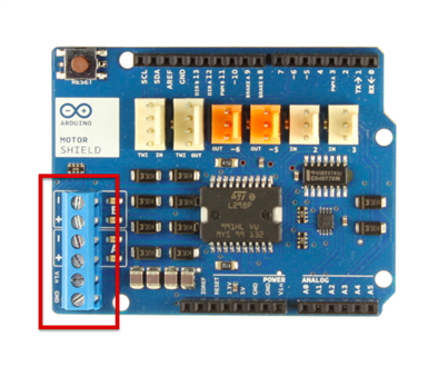

A DC motor cannot be directly connected to a PWM pin because it requires too much current. That's why we need a motor shield. An Arduino shield is a board that plugs on the Arduino one, in such a way it gets connected to all Arduino pins. The shield will use some of them, the others are left free to the user.
The motor shield I am using has two DC motor channel, called A and B. According to the documentation, both channels use 4 pins. In particular, channel A, uses the digital pins 3, 9 and 12 as PWM, brake and direction control, respectively, and the analog pin A0 for sensing the current driven by the motor.
The DC motor is connected to the + and - terminals corresponding to the A channel. Another pair of terminals are used to connect an external power source, such as a battery (labelled Vin and GND), while a second motor can be connected to another pair of terminals, labelled B (see the picture, where the terminals are highlighted by a red rectangle).
The PWM pin (pin 3) is used to regulate the speed of the motor. The maximum speed can be obtained setting this duty cycle at 100%, i.e. setting the pin at its maximum vale (255). The brake pin has two states: LOW and HIGH. When HIGH, the brake prevent the motor from moving. The direction pin, too, can be either LOW or HIGH: depending on the way in which the motor is connected to the terminals it set the direction of the rotation to be clockwise or anticlockwise.

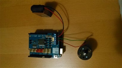

Of course this is for demonstration purposes only. You can now use the go() method to let the motor rotate as you need. In the pictures below you can see my motor connected to the Arduino shield and to a 9V battery.

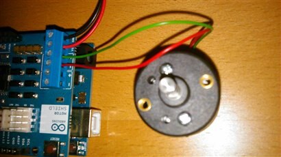

The picture on the right shows how the connections are done on the motor shield.
