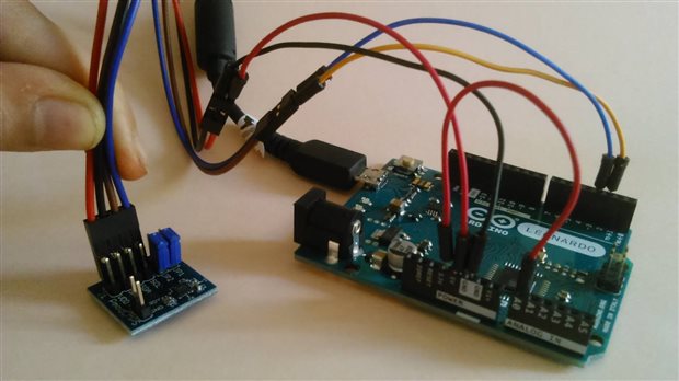

The Digilent device integrates the digital compass IC with a circuit that allows the user to read the three ADC's value using I2C, one of those many serial protocols to exchange data. A serial protocol is a way to send and receive data between a CPU and a peripheral device using just one single line (an electrical wire) called SDA (Serial DAta). Binary digits travel along this line one after the other in both directions. The communication being serial, it is important that each bit is transferred along the line at regular time intervals. A second line, called SCL (Serial CLock)  is then employed to provide a clock signal allowing both transmitter and receiver to schedule the transmission/reception of signals properly. In order to use the device, then, you just need to feed it with 5 V, and connect the two I2C lines to an I2C enabled device such as an Arduino. The device (in the picture) comes with four pins: two of them must be connected to the ground (GND) and 5 V, respectively, while the other two pins are marked as SDA and SCL for communication.image
You can connect these four pins to the corresponding pins on an Arduino board. The I2C pins location on Arduino depend on the board flavour. On the most popular Arduino UNO board they correspond to A4 and A5 pins. In this post, however, we are going to show how to use the digital compass using an Arduino Leonardo board, where the I2C pins are located on digital pins 2 and 3. See the Arduino - Wire page for details bout other Arduino flavours. The reason for using the Leonardo board is that it comes with built-in USB communication capabilities that makes it appear as an USB keyboard or mouse to a computer, hence we are going to use this feature to show the magnetic field vector on the screen.
First of all, connect the four pins of the digital compass to the corresponding pins on Arduino, then open the Arduino IDE, select the proper port and board, if needed, and start coding. In the picture below you can see the four cables connecting the Arduino board to the device. The need for the fifth (red) cable connecting the 3.3 V pin of the Arduino with its A0 pin is explained below.

    Thanks for a nice clear write-up.
    In your photo, it looks like you are powering the PmodCMPS with 5v, but the datasheet states maximum 3.6v.
    Can you confirm that you are feeding it 5v ?
    I did the same thing, but am getting no I2C response and suspect I fried my sensor.
