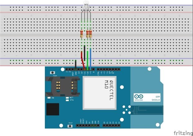

Hi
I have been playing with my Uno and GSM shield to try to see if I can get the real world to react to a good old fashioned SMS text. In these days of 3G and 4G data rates, I wanted to show that we don't have to have the latest toys to interact with the real world.

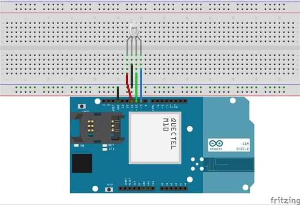

So, to start I am using a common cathode RGB LED with a first gen Uno with an R3 GSM shield wired up as below.
(Please imagine an Uno underneath this shield :-))
So, the idea is to react to the contents of an incoming text message and light the LED with the colour that is sent to the Arduino. (A this point the choice is red, green or blue).
At the moment I am working on IF statements to check the contents of the message as it arrives but I am probably going to change this to either a case statement or with the message passed as a parameter into a new function. Anyway, the code as it stands at the moment:

So, there you go, a good old fashioned text message that says red, (or ReD due to the toLowerCase() function), will light the led a nice red colour. I will make some changes to the code, it comes in at 17,056 bytes of program storage space with 1,196 bytes of global variables so I thank that I want to tweak it a bit to see how efficient I can make it.

    Hi Markvenn, I have tried your code using a different setup. I used a SIM800L based GSM board with Arduino duemilanove.It worked as expected, if pins 2 and 3 are maintained as the serial communication lines. The problem is if you send an sms text other than red, green, blue, the setup hangs ie subsequent sms with red, green or blue will not work anymore until power is switched off and on.
    I want to find out if you experienced that and what could be the possible solution. Thanks

    I forgot to put in the resistors on the fritzing breadboard :-(
