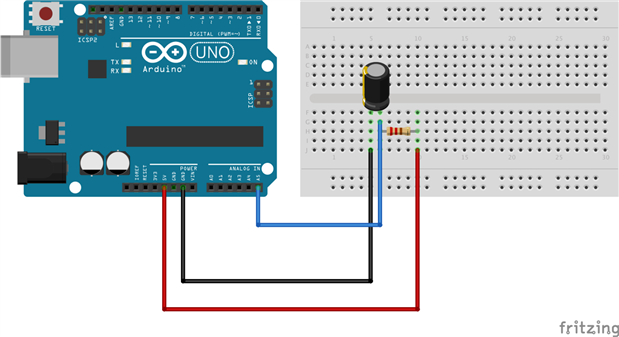

The circuit, shown in the picture below (made with Fritzing), is easily realised connecting one of the leads of the resistor to the 5V pin of Arduino; the resistor is mounted in series with the capacitor that, in turn, has its second lead to the ground (GND). In order to measure the voltage across the capacitor, we connect the first lead of the capacitor to one of the Arduino analog inputs (A5).

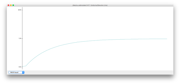

The first loop, then, is needed to start the program as well as the Serial plotter, having the time to connect the red wire to the 5V pin. Only when such a wire is connected to that pin the capacitor starts charging and the voltage across its leads starts raising. At this point we just read a fixed number of values of such a voltage (480 in our case) and write them on the Serial monitor. Each value written to the Serial monitor is shown on the Serial plotter versus time (in fact each value written to the Serial monitor is plotted against a sequential number, but in our case the readings are made at almost constant intervals of time, hence the horizontal axis values are proportional to time).
Once we read all the values we just stop doing anything with the last loop. The result is shown below.

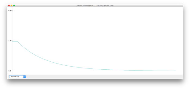

Such a very nice curve is exactly what we expected. You can even measure the discharge curve just repeating the experience in the following way: once charged, the capacitor remains charged until it is short circuited on the resistor. So, just disconnect the red wire from the 5V pin, restart the program and the Serial plotter, and connect the free lead of the red wire to the ground. The capacitor starts discharging on the resistor and the voltage across it changes. Soon after, the program makes 480 readings of the voltage and plot them, as can be seen below.

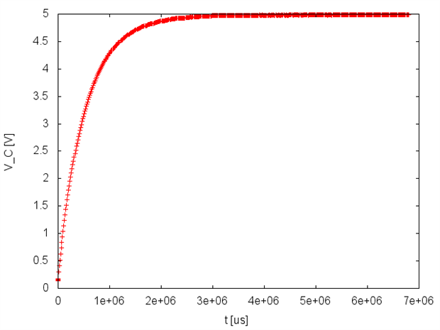

We write those two numbers to the Serial monitor, then copy and paste them into a text file for subsequent analysis. The picture below shows the data collected by us, during the charge:
Times are in microseconds and you can see how rapid is the process. The capacitor is almost at its full charge already after 2 seconds. We used a resistor whose resistance was R=9.94 kΩ. We can then get the value of the capacitor from these measurements. With some mathematics one obtains a time constant θ of 0.53 s, from which we can derive C as θ/R≈54 μF. The nominal value of the capacitor we used is 47 μF. The error in the determination of it is then less than 15%.
