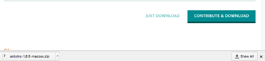

You can download the Arduino IDE here:
https://www.arduino.cc/en/Main/Software
and find older releases here:
https://www.arduino.cc/en/Main/OldSoftwareReleases

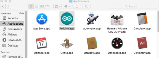

Unzip the folder and place it in your Applications folder:

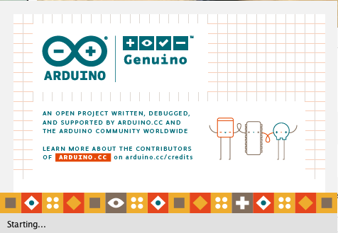

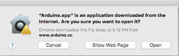

Launch Arduino.app in the Applications folder and you should see this:
Hit Open when you see this popup:

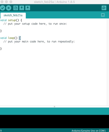

when it's done you should see the editor and a toolbar at the top of the screen.
Your editor will now look like this:

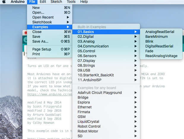

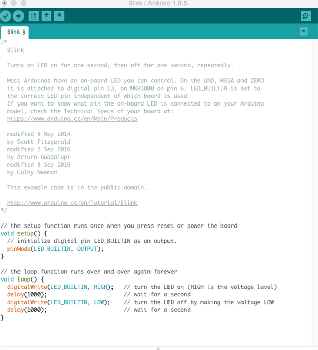

If you are learning Arduino for the first time you can grab what are known as sketches.  Sketches give you the code you need to put something into the editor to make your Arduino do something useful.
Coding is something you learn from simply doing.  To help you get started along your journey there are included sketches including a sketch that blinks the built-in LED on an Arduino Uno.
You'll now have a sketch which you can use to program the microcontroller on your Arduino to  blink the built-in LED pin:

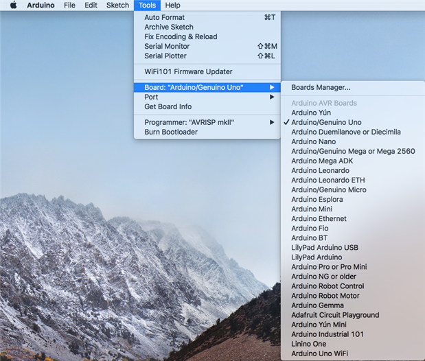

Under the Tools -> Board ensure that you have the right board selected (this example is using the Uno)

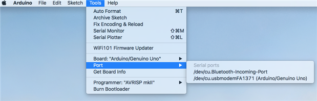

Tell the board what port your board is connected to Tools -> Serial Port
On Linux and Mac this looks like /dev/tty.usbmodem* or /dev/tty.usbserial* where * is the a string of alphanumerical characters.
This is what mine looks like:

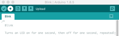

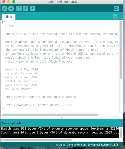

I go back to the Blink LED Sketch at the top and I'm ready to upload my first Arduino program.
To upload the program I click on the arrow next to the check mark (they really do make this as simple as possible):
I click on the button and look at the bottom of the IDE screen to see if its working:
You can watch the progress bar on the bottom of the IDE to watch as your sketch compiles and uploads to the microcontroller.

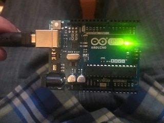

Once completed, the yellow LED on your Arduino will blink once per second.
This is how mine looked:
Reading the Code:
  • If you've taken any kind of programming class or are at least familiar with HTML then you are aware of commenting.   Anywhere you see something like /*  */ or / /  , those are comments and have nothing to do with the code instructions that you are sending to the machine.  These comments make it easier to debug coding or for another developer to pick up and debug your code.  The open source nature of Arduino allows other programmers to pick up and fork out existing code so when you get to creating code yourself,  be sure to include these wherever possible to prevent a mess!

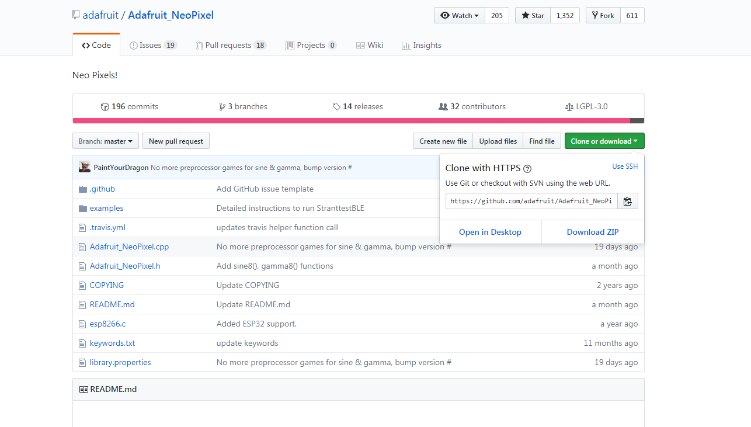

As you get more involved with Arduino you are going to want to interface your board with a chip or a sensor.
For this kind of thing, Github is your friend.
May Arduino libraries are available on Github, thanks its the embrace of the Open Source Community.
Be sure to download the full zip file:
In this example the file is name Adafruit_NeoPixel-master.zip.
Use an unzipping program to unizip the folder.
remove master and any spaces, underscores, or dashes between the text so that it looks like this:
AdafruitNeoPixel
Under Sketches -> Import Library -> Add Library
That's it!   Your Library is now available for you to use!
