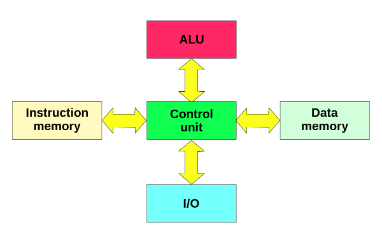

Harvard Architecture
The Princeton architecture was better suited for the time because using one memory was preferable because of the unreliability of current electronics (before the widespread use of transistors).  A single memory interface would have fewer things go wrong.
The Harvard architecture was largely ingured until the late 1970s when microcontroller manufacturers realized the advantages for the devices they were designing.
The Von Neumann architecture's biggest advantage is that it simplifies microcontroller design because only one memory is accessed. Meanwhile, the Harvard architecture executes instructions in fewer instruction cycles than the Von Neumann architecture.  Each architecture has its advantage.  The Harvard model has the edge on performance while the the Von Neumann is more flexible.
