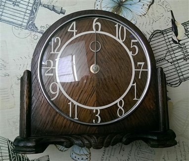

Using an Arduino Micro Pro module along with a real time clock and a darlington driver array I created a working Topsy Turvy Clock.
The electronics was not particularly challenging, I effectively wired 3 off the shelf components together using a motherboard/module approach. The stepper motors had a gearbox so to know the absolute position I added a clear disk with a segment marked off with tape which passed through a slotted opto sensor. On startup the clock homes each of the motors before moving to the correct locations.
If you've any questions about the electronics or anything else about the clock, please leave a comment.

    Workshopshed over 12 years ago in reply to mcb1 +2
    The electronics are on the back.

    I've created an FAQ and instruction video, some people were having difficulty telling the time
    Workshopshed: Topsy Turvy Clock - FAQ
