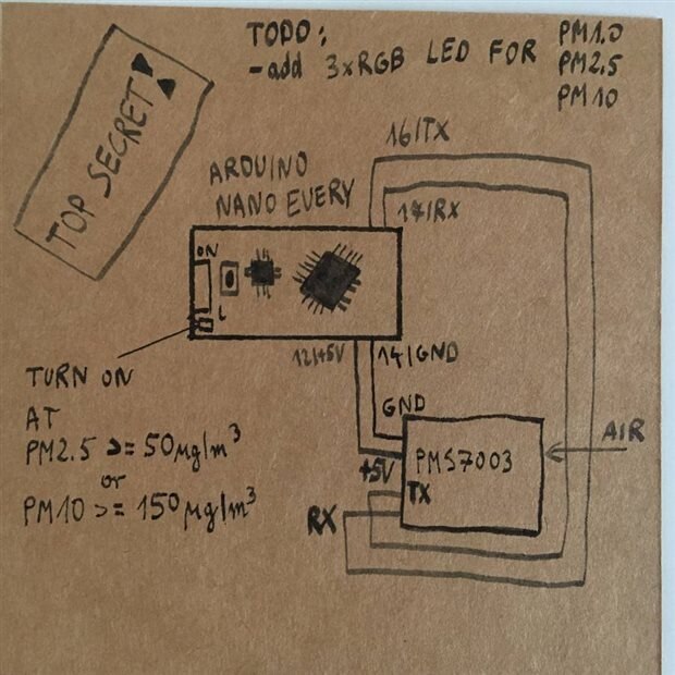

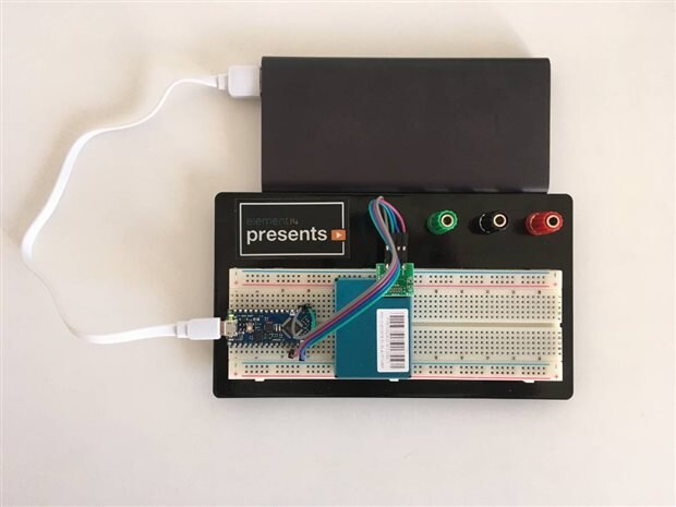

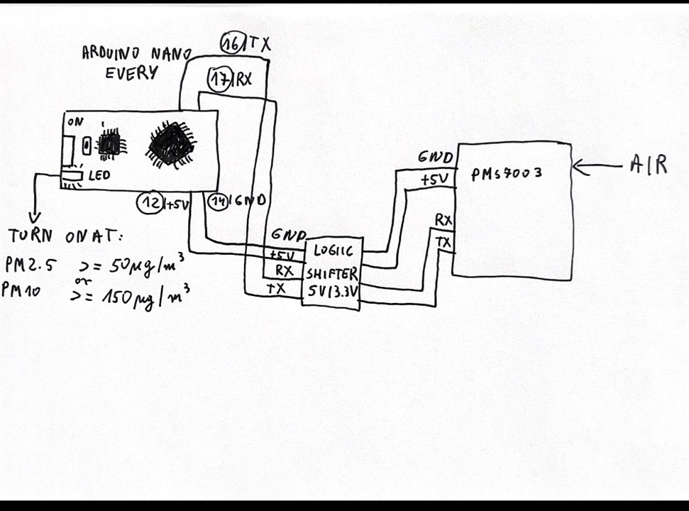

The basic idea was to create simple air quality monitor. I have used the PMS7003 sensor which is able to measure PM1.0, PM2.5 and PM10.0. This sensor was connected to the Arduino Nano Every. Received data from sensor is available via serial port in human readable format. Additionally, an alert appears when PM2.5 and PM10 exceed the safe limit (the built in LED is this indicator). Below there is diagram with connections (Important the logic level shifter is needed at TX/RX connection):
