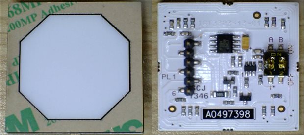

It is an ‘off-the-shelf’ innovative module that combines a touch switch (no moving part) with a multi-colour backlight.
It is effectively a capacitive switch with built-in (Red/Green/Blue) RGB LED fitted within a thin assembly, see Figure 1.
It comes in two standard square sizes of 35mm and 20mm.
The 35mm module includes 4 built in LEDs whereas the 20mm module contains only one.
The free sample I got was the 35mm module which is the one described in this article.
Figure 1 - 20mm and 35mm modules (courtesy of Stadium IGT)
The module is designed to be mounted behind a glass or Acrylic panel with a thickness of up to 11mm.
The touch sensitivity is preset by 2 micro switches fitted on the rear of the module.
It comes with a self adhesive patch for easy fitting. Other more robust fitting techniques should also be considered.
At time of writing, free samples are available from ACAL BFi [1].
Figure 2 - Front and rear of 35mm module

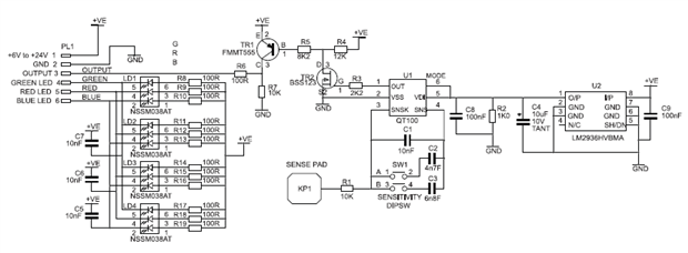

The schematic for the 35mm module is provided in the module datasheet as shown in Figure 3.
The schematic shows 4 RGB LEDs [3] in a single package, an LM2936 [4] low dropout voltage regulator and touch sensor QT100 [5].
Figure 3 - Module Schematic (courtesy of Stadium IGT)
The height for RGB LED package is 1.2mm.
The LED forward voltage is 3.2V (Blue/Green) and 2.1V (Red) typical when a forward current of 20mA is applied.
The maximum forward current is specified as 35/50mA at constant current or 110/220mA with a current pulse width less than 10ms and duty cycle less than 10%.
The luminous intensity is quoted as 240/1100/550 mcd for Red/Green/Blue with 20mA forward current.
The LM2936 is a voltage regulator from Texas Instruments (was previously National Semi).
It provides a regulated output voltage of 3.3V to the touch sensor from the 6-24V input power supply.
The LM2936 is a linear regulator so high supply voltage will result in power wasted in the form of heat dissipated by the regulator.
The QT100 touch sensor is an integrated circuit that detects proximity or touch.
A charge transfer method senses an increase in load capacitance caused by the human body in close proximity to the “sense pad”.
The sense pad is probably built onto the switch module PCB. More information is available in Quantum Research Application Note [6].
The QT100 was originally made by Quantum Research Group which was later acquired by Atmel in 2008.
The QT100 has been replaced by the AT42QT1010 from Atmel.

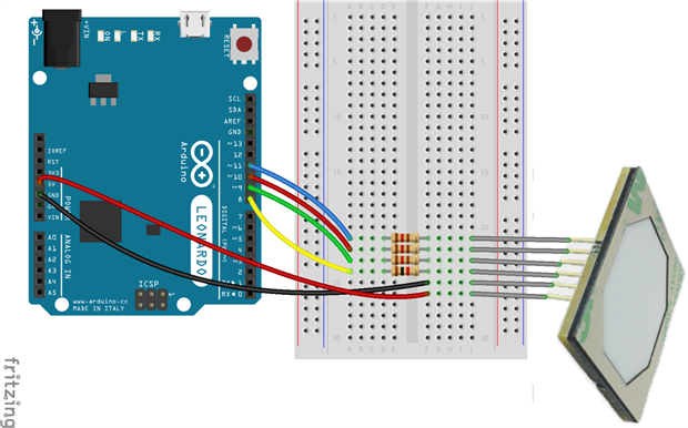

Simple Interfacing with Arduino
The module was evaluated with an Arduino Leonardo board.
The connection between the Arduino board and the module is given in Figure 4.
Figure 4 - Captured with open source Fritzing application [7]
The module is powered from the Arduino board 5V output power.
The module datasheet specifies a 6V to 24V supply but it operated correctly at 5 volts.
It is not clear why the supply voltage is restricted to 6 volts.
The easiest way to drive the RGB LEDs is to connect them directly to Arduino digital output pins.
The Green, Red and Blue LEDs are connected to pin 9 to 11 respectively.
These pins can be programmed to output a Pulse Width Modulation (PWM) signal, refer to the Arduino PWM tutorial [8] for details.
The microcontroller IO pins on my Arduino board can sink a maximum current of 40mA, with the total current not exceeding 80mA.
However it is recommended to limit current to around 20mA. So resistors were added to limit the current sink on pins 9 to 11 to 20mA.
Driving of higher current LED can be achieved by controlling a transistor gate, such as the commonly used PN2222 NPN bipolar transistor.
The output from the capacitive sense pad was connected to pin 8. A current limiting resistor was added inline as a precaution.
