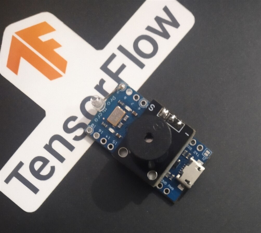

The annoying caps lock buzzer looks like a keyboard to the host PC except it doesn’t have any keys. The host sends the periodic USB output reports to our “keyboard” and when the USB output report is received, our “keyboard” turns the buzzer on or off to match the state of the CAPS LOCK bit in the USB output report.
Think of it like the little indicator LED on your keyboard, but one that makes a terrible screeching noise that you simply can’t ignore. This is made possible by the fact that the Caps Lock status is handled at the OS level rather than the local input device.
As a side effect, you’ll always know when CAPS LOCK is enabled so entering the wrong password, joining lines when you’re just trying to scroll down in to your thesis report , or answering an entire email (to your .boss.) in ANGRY SCREED format should be history.
THINGS
-Arduino Pro Micro
-Small Buzzer (can be directly powered through Micro)
-An LED (optional; but I chose green one)
Without using the PIC ones (showcased in the original build), I chose to use ATMEGA32U4 based Pro Micro, which also provides the necessary USB 2.0 Data lines for both programming the microcontroller and as a dedicated USB - HID Device (emulated as Keyboard, Mouse, Joystick, PenTest, Rubber Ducky, Remote Injection Tool, etc. etc...tested them all .yay.)
Connections (Clean n Simple)..
- Connect Buzzer+ to pin 3 on pro micro, LED on 9 (your choice) and the rest is ground. You can also use 'pinButton=2 (pull-down)' to initiate a reverse Caps Lock on PC Keyboard from the microcontroller;  'Hacky-way to control'.

(Be sure to include the HID-Project Library from within the IDE Lib Manager; code works for Pro Micro & Leonardo based on Atmel.32U4), may work on Teensy.
'LHS=RHS'     ...Proved!
  • BORKENHANGEN
    BORKENHANGEN over 2 years ago
    thank you. My problems were blown away in an instant. I really appreciate the code you wrote.
