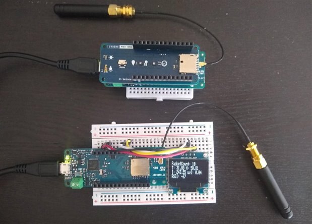

I am road testing https://www.element14.com/community/roadTests/2184/l/Arduino-MKR-WAN-1300-+-ENV-Sensor-Shield ,  and this is simple point to point communication test using two Arduino MKR 1300.  As part of the test I am using an Arduino MKR Environment shield on one of the MKR 1300  boards and other board is connected to an OLED display to show the Temperature, Humidity , Illuminance, and UVIndex. In addition as you see in the picture below, I am also keeping track of the packet count and RSSI value.

In addition, I also took the receiver module for a walk with the sender connected to my laptop at home with a simple sketch loaded, and I would have walked for approximately 400 to 500 meters from the home, and was still receiving packets, I decided to turn back as I am still recovering from an ankle injury. I will have a proper range test done with the antenna's as part of the road test.
And the antenna's that you see attached on the board are 915 MHz from TTGO LoRa32 SX1276 with ESP32 and SSD1306 OLED boards that I purchased about a year ago.

    Interesting system. I am impressed that you managed a range of 400 m without problems. How did the RSSI vary? I have undertaken some measurements with RSSI using laptops and the values would vary constantly…
    dougw over 6 years ago in reply to carmelito +3
    That is pretty good. I got about -117 dBm at 400 m and -121 dBm at 783 m using 5dBi gain antennas, with lots of houses obstructing a direct line-of-sight.
