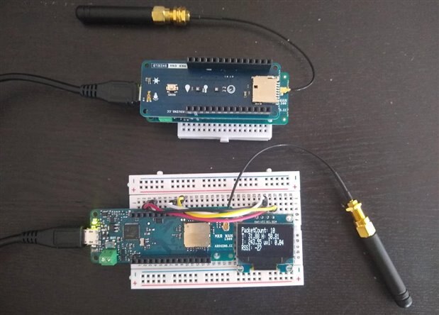

I am road testing https://www.element14.com/community/roadTests/2184/l/Arduino-MKR-WAN-1300-+-ENV-Sensor-Shield ,  and this is simple point to point communication test using two Arduino MKR 1300.  As part of the test I am using an Arduino MKR Environment shield on one of the MKR 1300  boards and other board is connected to an OLED display to show the Temperature, Humidity , Illuminance, and UVIndex. In addition as you see in the picture below, I am also keeping track of the packet count and RSSI value.

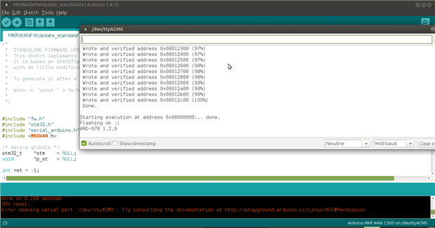

Now before you get started you will have to install MKRWAN Library and also update the latest firmware on the MKR 1300 using the MKRWANFWUpdate_standalone sketch, you should find this in the example menu are the library is installed.

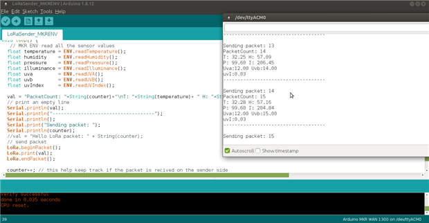

Here is the Sender code, uploaded on the MKR 1300 connected to the MKR ENV shield

Serial monitor output from the sender

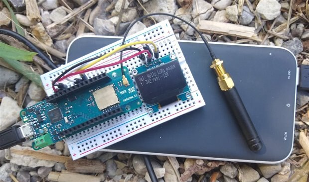

In addition, I also took the receiver module for a walk with the sender connected to my laptop at home with a simple sketch loaded, and I would have walked for approximately 400 to 500 meters from the home, and was still receiving packets, I decided to turn back as I am still recovering from an ankle injury. I will have a proper range test done with the antenna's as part of the road test.
And the antenna's that you see attached on the board are 915 MHz from TTGO LoRa32 SX1276 with ESP32 and SSD1306 OLED boards that I purchased about a year ago.

  • carmelito
    carmelito over 6 years ago in reply to dougw
    I was getting a RSSI of around -90dBm , and when I placed it on the ground to take a picture it hit -120.
