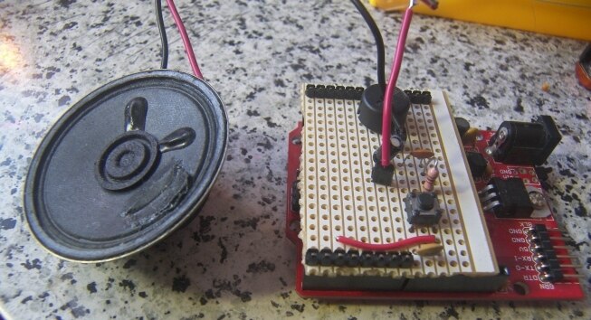

   So my next decision was which type of key to emulate. I decided to make prototypes of both straight keys (which are still popular today) and iambic keys. You can see what an iambic key looks like to the left. I'll show you how I designed both of them in this blog. The straight key was the simpler of the two, both in software and hardware. Essentially, all that is needed is a single button that causes the software to create a beep which is sent to an external speaker. However, there are always a few different ways to do the same thing. In order to get a prototype up and running quickly, I decided to use my Arduino. I have a SparkFun RedBoard, but they are functionally identical to the Arduino Uno . The reason I ended up with a RedBoard is that I wanted to build mine as a kit. The drawback is that the USB port isn’t integrated; I’d recommend picking up a pre-assembled Uno,like this one . You can use any Arduino for this project, as long as you know which pins produce pulse-width modulation signals (PWM).
     In order to make this as easy as possible, I took a piece of protoboard and cut it to fit over the footprint of the Arduino headers (see below, with the protoboard upside down beside the Arduino). I then simply soldered pin headers to each side of this piece of protoboard and then attached a button, a 1k pull-up resistor, and also a couple of female header pins for the external speaker to attach to. The button is attached to digital pin 2, and the output of the speaker comes from digital pin 6, which is one of the PWM outputs.
While you could simply put a routine inside the loop() function that constantly checks to see if the button is pressed, I found it much easier to use interrupts. If you’re not familiar with interrupts, or you’ve never used them before, there are many tutorials online describing how they work.
     Instead of checking the button in an infinite loop (which would work, but then the processor would just be sitting there screaming along, checking the button over and over as fast as it possibly can – future expansion of the code would be difficult, if not impossible) I decided to use interrupts. When the button is pressed, it triggers what is called an ‘external interrupt’, which means the interrupt is generated from an external source. In our case this is our ‘key’ button. Understanding interrupts is simple – they are exactly what they are named – interrupts! When an interrupt occurs, the processor is interrupted in whatever it’s currently doing. The processor stores whatever it is working on in a temporary area, then immediately jumps to execute the interrupt
handler. The ATmega328P has many different interrupt sources, many of them inside software. For example, you could have an external interrupt from a button. When you push the button, the processor stops whatever it’s doing, and then light a LED. It then goes back to what it was doing before. Interrupts are an extremely powerful tool. Not only do they help reduce the use of unnecessary loops, they are also vital to time-sensitive tasks like sampling an analog-to-digital converter. Because I used interrupts, I had to blend C with Arduino code. Those familiar with Arduino will see that the setup() and loop() functions are still there. I’ve just added on a couple extra functions to handle the interrupts and also what to do on start-up.
     Enough about interrupts – let’s move on to the beeping! The Arduino libraries include a way to activate PWM without needing to know much about the AVR registers. You’re probably already familiar with the command if you’ve used an Arduino before – analogWrite(). The name is slightly misleading, as you’re not actually writing an analog value to a pin. The analog value is being averaged by using PWM. However, in most cases – such as lighting an LED, driving the speed of a motor, etc. – the user can’t tell the difference because the PWM is happening so fast it just seems like an analog value.
PWM can also be used to create tones out of a speaker – after all, we’re just generating a frequency. If we bring that frequency down into the human hearing range, we could make the chip play Bohemian Rhapsody if we wanted! The problem is, the Arduino command analogWrite() doesn’t have any way of controlling the frequency of the PWM. So I had to use C for that part of the code. What I’m actually doing is activating the timer module attached to pin 6. I’m then telling it I want PWM mode. The PWM frequency is based off of the system clock frequency. Most Arduinos run at 16MHz, or 16,000,000 Hz. Since the timer is 8-bits wide, it can only count up to 255. So if we had the clock running at full speed, the timer would overflow once every 16,000,000/255 seconds, or 62,745 times a second. With a duty cycle of 50%, this would mean a frequency of 62.745 kHz, which is WAY too high for the human ear to listen to. This is a good frequency for motors and LEDs, but we need something around 1 kHz if possible. Luckily, the AVR designers were thinking, and included a prescaler option. This means we can divide the clock frequency by a set value. Our options are 8, 64, 256 and 1024. These would produce frequencies of 7.8 kHz, 980 Hz, 245 Hz, and 61.2 Hz, respectively. Wait a minute – 980Hz, that’s almost 1 kHz exactly! How perfect! So I chose a prescaler value of 64. This will create a tone that is very close to what most radios produce when the Morse key is pushed.
     Now that we have the tone out of the way, we’re essentially done! The code activates the external interrupt associated with digital pin 2, where our button is located, and when the button is pushed the interrupt turns the PWM on. When the button is released, it turns the PWM off. Wow! That was easier than I thought it would be. I threw in a start-up routine for kicks. When the Arduino is reset or turned on, it will spell out CQ in Morse code. This is the Morse code for “calling anyone”.image

  • mraureliusr
    mraureliusr over 11 years ago in reply to e14 Contributor
    I'm sorry, I didn't see this comment when you posted it!
    It's actually not as easy as just changing the pin number, you need to make sure the pin you want is an 'output compare' pin (on the datasheet it'll say OCA0 or something similar next to the pin) and then change the register value in TCCR0A (which might have a different name in the ATtiny13).... if you need help, feel free to email me for more assistance!
    Thanks again for sharing your code.  I have been modifying it to get a stripped down version to run on an ATtiny13.  I'm working on making small beacon circuits for my flying groups RC aircraft.  I don't have C programming skills.  I'm wondering if you can give me some help with code changes to move the output pin from pin 6 to pin 4 so my stripped down version of your code will work with the ATtiny13.
    You might be interested in the thread on RCgroups where the idea for the trackers are discussed.
    http://www.rcgroups.com/forums/showthread.php?t=2079662
    http://www.rcgroups.com/forums/showthread.php?t=2012386
    Check out the above threads and thanks for any help you can give me with my project.
    Curt
    OK, looking at the code with rested eyes this morning it looks like I can just change the value from 6 to 4 in this line of the code and it should move the output to pin 4 and not effect the rest of the program.
    const uint8_t speakerPin = 6;
    I'll give it a try later today, headed out to fly in a few minutes.  I'll give an update after I try changing the code and loading into the ATtiny13.
    Thanks Again!
