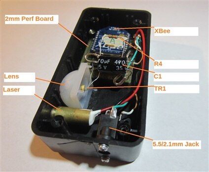

The laser tripwire is set up to be as simple as possible. A laser is reflected off of a mirror and back to a photoresistor which is one leg of a voltage divider. The complete schematic is attached below. The varying light intensity changes the output of the voltage divider, which can be read by an A/D. To make the 'target' for the laser easier to hit, a Fresnel lens is used in front of the light sensor like one would see with a PIR sensor.

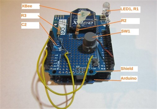

Arduino Design:image
Shields are possibly the biggest time saver that exists in the Arduino ecosystem. The XBee board is on 2mm pitch headers, and having some extra perf board to put the low pass filter and button on is super helpful. Arduino's wireless shield worked great for both challenges.
The filtered output from the receiving XBee is fed into an Arduino Leonardo for processing. The code is attached below, but the basic pseudo-code operation is:
Save the last sensor value
Read a new sensor value
If the new sensor value is greater than the past value by at least a threshold, detect a trip
Blink the LED and wait for a timer to expire or a button press
Loop back to the start
In order to make the tripwire system work at any light level, a simple comparator action wouldn't work. The threshold at night would need to be different from a daytime threshold. It would be possible to take an ambient light reading with a separate sensor and base the threshold on that, but a more elegant solution for this application would be to pay attention to the rate of light change. If the light changes by X amount within a very short period of time, a trip is registered. However if the light changes over a few seconds or minutes, it will not register a trip. Testing has shown this to work in pitch black as well as on a sunny day (although in the shade).
Mechanical Design:
With the electronics designed and code written, I had to put the transmitter in a project box to shield it from the elements. I found a simple enclosure, although I needed to remove the included metal plate. According to Digi's layout suggestions on page 9 of their manual, there are limitations on where metal can surround the area near the antenna. A hole for the lens, the laser, and the power supply were the only mechanical modifications required.

  • The power supply that I bought was so crappy and noisy that is was causing bad data to be sent. I had to add a 470uF electrolytic cap at the power input. A higher quality supply should be used.
