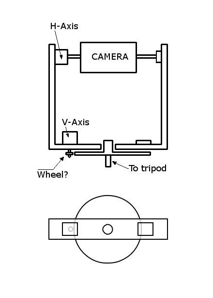

Hello mates.
Here I come again...I really continue figuring out how to reach a very mall and continous speed of rotation, with a very high precission.
What I want to make is a mount to put on a camera and shoot photos of the night skies. My original idea was in the line of control the movement of my telescope, but I think this is unreacheable in my monetary conditions.
So I am here with this paint schema image
The mechanism has aproximatelly 30 cm width and 30 cm height.
The structure will be made with plates of alluminium of 1,5 mm wide
You can think the camera is a small reflex camera (like Nikon D3200)
I had thought that I could reach this with an Arduino UNO board and a pair of sttepers. But when I have started to play with the Arduino board that I bought, some thoughts have come to me. I dont know how to choice the better options.
  1. Will I be able to make this mecha move with a pair of small sttepers 28BYJ-48 with ULN2003 driver?? I have not got the structure pieces yet, so I have not been able to probe this yet.
  2. What do you think will be the better way to control the movement of motors? Bluetooth, IR, RF?
  3. If I would wish to know the angle where the camera to be pointing, ¿what would be the better way? Would I need any optical sensor? or it would be enough with some variables in the code with which I control the sttepers to know this data?
  4. Whatever the choice of motor type, I need to know how to provide movement in the vertical axis. I mean: it would be better a small gear in motor axis and a big gear in the basis? or a wheel in the axis of the motor and a simple circle as basis?
Thank you in advance.
And please, escuse me if I explained it bad

    But I have read the comments and my idea need to be revised... With only two axis I cannot get the rotation of sky so i need al teast one more motor. And the entire device need to be positioned manually pointing to Polaris and then make the move to point and follow an object. As i said, the whole idea need to be revised.

    take a look to these two links. This is a smaller structure but if you need we can study something that will work for the DSLR camera, that is the next step of the project.
    https://www.tindie.com/products/alicemirror/tiltpan-micro-camera-kit/
    and
    https://www.tindie.com/products/alicemirror/tiltpan-arduino-shield/
    This version is for the stop-motion photography but it doesn't matter because the applied principle is the same. In this case I have used servos and - despite that I appreciate the steppers - I saw two important things developing and testing this proejct; The first is that cheap servos has a considerable torsion and the second is that until now I was able to avoid the dual gear transmission because with microimpulses servos can move very short.
    Now the product you see in the videos works with two common servos but the base can be also work fine with a 360 deg servo (not a modified one, a real full rotation servo).
    With the GoPro and - more - with a heavier DSLR camera there is the problem that the direct traction (coaxial) base servo has serious difficulties to maintain a correct horizon. So, as you can see in the two attached images (done with the mobile of the piece on my desk, no-quality at all, sorry) I have designed a base with recirculating ball bearing included that fits perfectly stable. As you can see in the images of the links on Tindie above with the GoPro (about 100 gr weight) I have also used a small bronze with iron balls bearing (less than 1$ cost) to keep the camera stable when following the azimuth.

    balearicdynamics over 11 years ago in reply to Workshopshed
    Andy, frankly I don't consider this a "problem", at least not in terms of an issue. This aspect is well managed by the mill machines and the self-zero point in the steppers is a common practice. Take a look to a video of the first mill machine I have done with three-axis steppers controlled by an arduino. With a single input pin and three microswitches (you can save one direction per axis) the problems is solved with a very high repeat precision.
