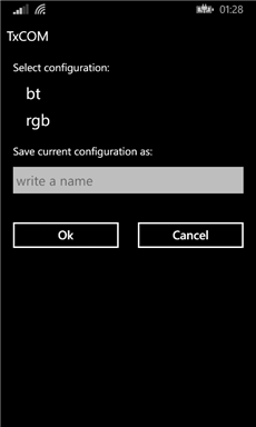

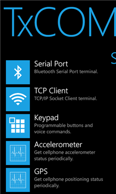

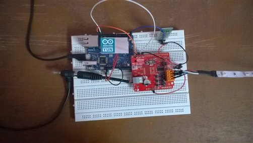

Hello Everyone, This is my second blog post for the Internet Of Holiday Lighting Road Test. In this post I will discussing how my setup for the Bluetooth Communication Between My phone and Arduino YUN, Below is the photo of my setup:
As you can see there are only 4 main components to this setup, Arduino Yun, Infineon RGB shield, HC-06 Bluetooth module and the RGB strip itself, so lets talk about the individual components:
Arduino YUN : Arduino yun is a great piece of hardware its easy to setup, easy to work with and almost free form the hassle of wire, I was fortunate to get it for free and to be able to experiment with it is a big deal for me, as I am a student and have no particular source of income I am really grateful to Element14 for giving me this opportunity. The setup of arduino yun is really simple if you watch these videos by Julian Ilett  which I did.
Infineon RGB Shield : The Infineon RGB shield is easy to work with and excellent i color reproduction, also the connectors for the RGB strip and
the power are nice, However the source material on it is less and the demo code is difficult to understand, what I did is took the demo code and just modified it according to my needs, I didn't wanted to change it so much that it stops working. The code for this project is given below :

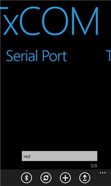

  void loop() {
    String msg = "" ;
  if(Serial1.available()>0)
    while(Serial1.available()>0)
    msg += char(Serial1.read());
    delay(100);
    if(msg=="red"){
  I2CWRITE6BYTES (ADDRESS, INTENSITY_RGB, 0x0fff, 0x0, 0x0); // red
    delay(100);

About The App I am Using ( TxCOM ) :
I use windows phone, Nokia Lumia 720 to be more specific, so I was not sure that I will find a good app due to Windows Phone app store having only a few apps for this, But the app I found is amazing !, it has almost every thing i needed for the purpose Some Images Below.
The App can send and receive serial data to the Bluetooth module, but the best features are the programmable keys and the voice recognition inbuilt on the app, it can also save many keys settings and can also transmit phones accelerometer and GPS data. I have made a small demo video which is Below :
