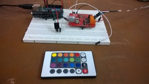

Hello Everyone, This is my third blog post for the Internet Of Holiday Lighting Road Test, in this post I will explain how did I managed to perform to change the color of RGB led strip with a simple IR Remote. Below is a picture of the setup :
Please watch the demo video it explains more than I can write about it...
HERE IS A DEMO VIDEO :
It is a very simple program, but first you will need to download this library : IRremote
once you do that everything is simple, just decode each button on your remote and make a case for each one of them.
the program simply reads the incoming hex code from your remote, and if the code match then the operation within the code is performed, in this code I have made it to change the color accordingly...

void setup() {
    Serial.begin(SL_BD_RT);
    Wire.begin();
    irrecv.enableIRIn();
    while (on != 1) // Wait for shield to respond, keep setting the values till it does

void loop() {
if (irrecv.decode(&results)) {  //If IR receive results are detected
    Serial.println(results.value, HEX);
    switch (results.value) {
    case RED:
         red();
    break;
    case BLUE:
