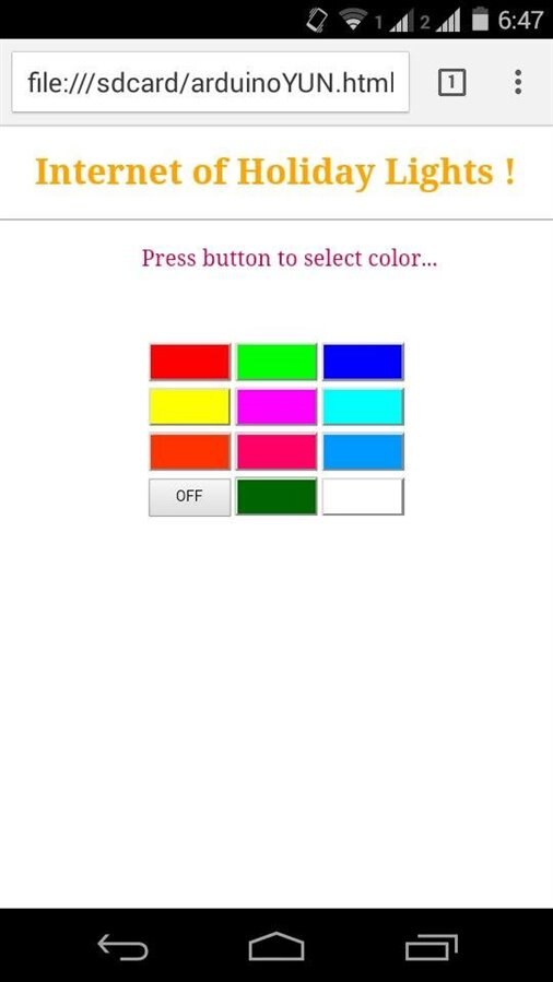

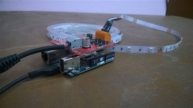

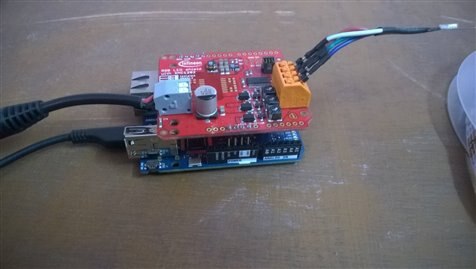

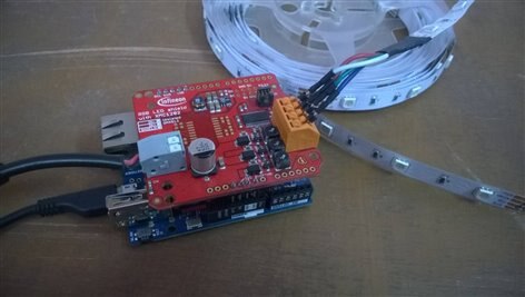

Hello Everyone, This is my forth blog post for the Internet Of Holiday Lighting Road Test, in this post I will explain how did I managed to perform to change the color of RGB led strip with a Web Browser . The setup is really simple it's just the Arduino YUN , the Infineon RGB shield and A RGB Strip.
Below ars pictures of the setup :
The Sketch ( Program ) is based upon the "MailboxReadMessage" example in the " Bridge " library, and the demo code for the Infineon RGB shield, The arduino is always ready to receive messages from a local computer in the same Wi-Fi network, and what I did was to read the message and equate it to predefined colors. example : I just had to type "192.168.1.17/mailbox/red"
to turn the red LED on. Below is the full code :

    if (msg=="red"){
        I2CWRITE6BYTES (ADDRESS, INTENSITY_RGB, 0x0fff, 0x0, 0x0); // red
      delay(100);
      else if (msg=="off"){
        I2CWRITE6BYTES (ADDRESS, INTENSITY_RGB, 0x000, 0x0, 0x0); // red
      delay(100);
      else if (msg=="green"){
        I2CWRITE6BYTES (ADDRESS, INTENSITY_RGB, 0x0, 0x0fff, 0x0); // red
      delay(100);
      else if (msg=="blue"){
        I2CWRITE6BYTES (ADDRESS, INTENSITY_RGB, 0x0, 0x0, 0x0fff); // red
      delay(100);
      else if (msg=="white"){
        I2CWRITE6BYTES (ADDRESS, INTENSITY_RGB, 0x0fff, 0x0fff, 0x0fff); // red
      delay(100);
      else if (msg=="cyan"){
        I2CWRITE6BYTES (ADDRESS, INTENSITY_RGB, 0x0, 0x0fff, 0x0fff); // red
      delay(100);
      else if (msg=="purple"){
        I2CWRITE6BYTES (ADDRESS, INTENSITY_RGB, 0x0fff, 0x0, 0x0fff); // red
      delay(100);
      else if (msg=="yellow"){
       I2CWRITE6BYTES (ADDRESS, INTENSITY_RGB, 0x0fff, 0x0999, 0x0); // red
      delay(100);
        else if (msg=="orange"){
        I2CWRITE6BYTES (ADDRESS, INTENSITY_RGB, 0x0fff, 0x0444, 0x0); // red
      delay(100);
      else if (msg=="aqua"){
        I2CWRITE6BYTES (ADDRESS, INTENSITY_RGB, 0x0, 0x0888, 0x0fff); // red
      delay(100);
      else if (msg=="pink"){
        I2CWRITE6BYTES (ADDRESS, INTENSITY_RGB, 0x0fff, 0x0, 0x0888); // red
      delay(100);
    else if (msg=="teal"){
        I2CWRITE6BYTES (ADDRESS, INTENSITY_RGB, 0x0, 0x0fff, 0x0888); // red
      delay(100);
  delay(1000);

I also made a HTML web app for this purpose, so that i can have a convenient interface and no need to type the address in the address bar, it ran perfectly on the PC and in the chrome browser on an android device. Here is a screenshot :
And here is the HTML code (Do change the address of my yun with your yun's address) :

<h1> Internet of Holiday Lights !</h1>
<hr>
<p>Press button to select color... </p><br>
<table align="center">
<h3><h3>
<tr>
<td ><a href="http://192.168.1.17/mailbox/red" onclick="window.open('#','_blank');window.open(this.href,'_self');"><input type="button" value=""style="background-color:#FF0000" id="one"  /></a></td>
<td ><a href="http://192.168.1.17/mailbox/green" onclick="window.open('#','_blank');window.open(this.href,'_self');"><input type="button" style="background-color:#00FF00"value="" id="one"/></a></td>
<td><a href="http://192.168.1.17/mailbox/blue" onclick="window.open('#','_blank');window.open(this.href,'_self');"><input type="button" value="" style="background-color:#0000FF"id="one"/></a></td>
</tr>
<tr>
<td><a href="http://192.168.1.17/mailbox/yellow" onclick="window.open('#','_blank');window.open(this.href,'_self');"><input type="button" value="" style="background-color:#FFFF00"id="one"/></a></td>
<td><a href="http://192.168.1.17/mailbox/purple" onclick="window.open('#','_blank');window.open(this.href,'_self');"><input type="button" value="" style="background-color:#FF00FF"id="one"/></a></td>
<td><a href="http://192.168.1.17/mailbox/cyan" onclick="window.open('#','_blank');window.open(this.href,'_self');"><input type="button" value="" style="background-color:#00FFFF"id="one"/></a></td>
</tr>
<tr>
<td><a href="http://192.168.1.17/mailbox/orange" onclick="window.open('#','_blank');window.open(this.href,'_self');"><input type="button" value="" style="background-color:#FF3300"id="one"/></a></td>
<td><a href="http://192.168.1.17/mailbox/pink" onclick="window.open('#','_blank');window.open(this.href,'_self');"><input type="button" value="" style="background-color:#FF0066"id="one"/></a></td>
<td><a href="http://192.168.1.17/mailbox/aqua" onclick="window.open('#','_blank');window.open(this.href,'_self');"><input type="button" value="" style="background-color:#0099FF"id="one"/></a></td>
<tr>
<td><a href="http://192.168.1.17/mailbox/off" onclick="window.open('#','_blank');window.open(this.href,'_self');"><input type="button" value="OFF" id="one"/></a></td>
<td><a href="http://192.168.1.17/mailbox/teal" onclick="window.open('#','_blank');window.open(this.href,'_self');"><input type="button" value="" style="background-color:#006600"id="one"/></a></td>
<td><a href="http://192.168.1.17/mailbox/white" onclick="window.open('#','_blank');window.open(this.href,'_self');"><input type="button" value="" style="background-color:#FFFFFF"id="one"/></a></td>
</table>
</tr>
</body>
</html>
