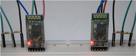

We need to configure both the modules. In order to do that we need to switch to AT Command Mode and here’s how we will do that.
First we need connect the Bluetooth module to the Arduino as the circuit schematics. Note that the “EN” pin of the Bluetooth module is connected to 5 volts and TX/RX pins goes to TX/RX of Arduino board. i.e. Tx -> Tx and Rx -> Rx
If the Bluetooth module led is flashing every 2 seconds that means that we have successfully entered in the AT command mode.
After this we need to upload an empty sketch to the Arduino but don’t forget to disconnect the RX and TX lines while uploading. Then we need to run the Serial Monitor and there select “Both NL and CR”, as well as, “38400 baud” rate which is the default baud rate of the Bluetooth module. Now we are ready to send commands and their format.
Slave Configuration
Type just “AT” which is a test command we should get back the message “OK”. Then type “AT+UART?” we should get back the massage that shows the default baud rate which is 38400. Then type “AT+ROLE?” we will get back a massage “+ROLE=0” which means that the Bluetooth device is in slave mode. If we type “AT+ADDR?” we will get back the address of the Bluetooth module and it should looks something like this: 98d3:31:3069b0
Now we need to write down this address as we will need it when configuring the master device. Actually that’s all we need when configuring the slave device, to get its address, although we can change many different parameters like its name, baud rate, pairing password and so on, but we won’t do it right now.
Master Configuration
First we will check the baud rate to make sure it’s the same 38400 as the slave device. Then by typing “AT+ROLE=1” we will set the Bluetooth module as a master device. After this using the “AT+CMODE=0” we will set the connect mode to “fixed address” and using the “AT+BIND=” command we will set the address of the slave device that we previously wrote down.
Note here that when writing the address we need to use commas instead of colons. Also note that we could have skipped the previous step if we entered “1” instead of “0” at the “AT+CMODE” command, which makes the master to connect to any device in its transmission range but that’s less secure configuration.
Verifying the configuration
That’s all we need for a basic configuration of the Bluetooth modules to work as a master and slave devices and now if we reconnect them in normal, data mode (i.e. disconnecting “EN” pin),
and re-power the modules, in a matter of seconds the master will connect to the slave. Both modules will start flashing every 2 seconds indicating a successful connection.

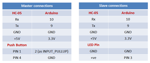

Let’s begin with transferring data from one Arduino to another using HC05 Bluetooth module.
In this example, we have attached one push button to master device. On pressing the button, it sends the single BYTE HIGH data to the slave device. When button is not pressed, it simply sends the single BYTE LOW data.
On the other side i.e. slave, upon receiving the HIGH BYTE, slave turns on the LED. If LOW BYTE is received, LED remains off.

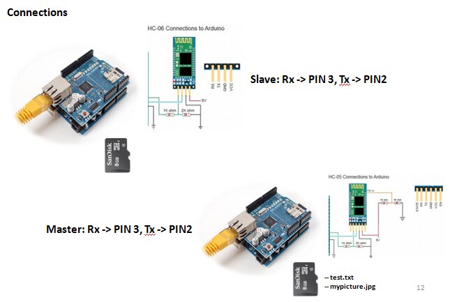

File and Image transfer between two Arduinos can be performed using two Bluetooth modules.
In this example, we will use HC-05 and HC-06 to transfer two files between two Arduinos. The master device sends test.txt and mypicture.jpg files to slave device.
The storage method is SD card in both sending and receiving ends. We can have two options to connect SD card to Arduino:
1)Using SD Card module
2)Using Ethernet Shield
We choose the second option

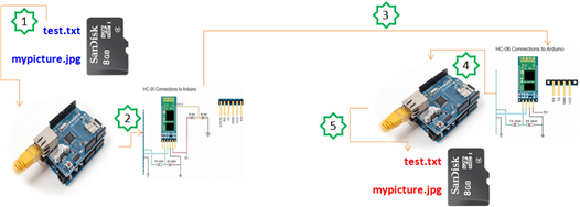

Algorithm:
Master side: Open the SD card, read test.txt file and send the data stream to slave device via HC-05. Repeat the same for mypicture.jpg file. Report any error during opening and reading SD card.
Slave side: Keep Listening to any incoming messages from master via HC-06. As soon as data stream is received, open the SD card, write first file and close. Repeat the same for second file. Report any error during opening and writing SD card.

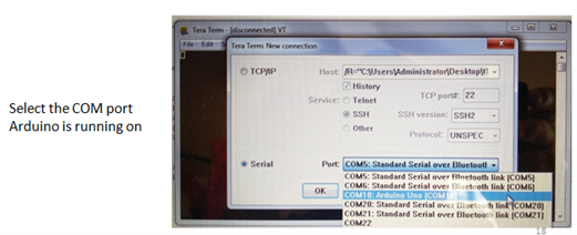

5)Open hyperterminal program. i.e. Tera Term (Good for serial communication). You can get it here: http://download.cnet.com/Tera-Term/3000-20432_4-75766675.html
6) Select the COM port as shown in the picture:

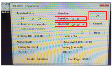

7) Go to Setup > Terminal
8) Set Receive and Transmit values as CR+LF and press Ok as shown below:
