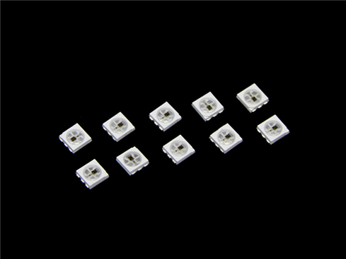

This is a quick blog to share my experience with trying to solder some WS2812 6pin LED chips onto my custom boards
I have about 14 strips to solder up and each strip contains 10 LED modules, the last time I tried to solder these, I had more fail than ended up on the board so I was determined to find a better way

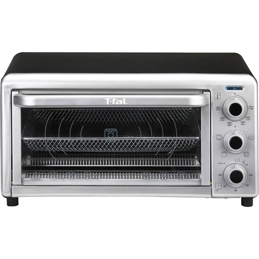

TEFAL Convection toaster oven I picked up new but on a big time sale at the local hardware store

bunch of WS2812 LEDs to solder that are a PITB to solder by hand

So I have been meaning to give the Oven a try after I had converted the controller to something designed for re-flow, alas time was against me so I decided to see how easy it is without all the fancy controls
Well as it turned out and as you will see in the video, it was actually quite easy (Well the re-flow part anyway), the application of the solder paste was a pain without a solder mask and my first attempts with a small flat screwdriver ended up with loads of bridges I had to clean up with solder wick

    yup, I tried once before and it was a disaster, those LED chips are very fragile and in tolerant to heat, an iron is out of the question to solder them, hot air soldering station is OK but the re-flow worked out to be easiest and the most reliable, now just got to practice applying the paste image
