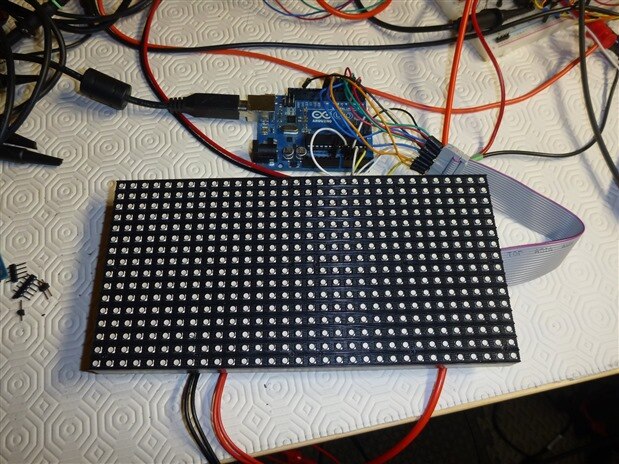

so what I wanted to do here was to have a matrix display to show a scrolling sign to say welcome to whom ever publishes their name to the "element14_IoT" topic of the Elclipse MQTT broker
I initially tried this using an arduino UNO and could get the display working no problems but there was no room for additional functionality like communications via radio and this was an important feature I wanted
over to Light Strip Larry, the MEGA star sports a significant amount of RAM and FLASH space, the Arduino mega was to be driving some WS2812 LED strips but this seemed more appropriate for a MEGA star and could work
Adafruit has a great article on getting this up and running on an UNO or MEGA and that part was straight forward, now all I needed was to modify it to handle an NRF24L01 while simultaneously driving a 32*128 pixel array of full colour LEDs, well we got there and this is the resulting code and wiring
This is the panel front and back
initial Adafruit article can be found here for those wanting to reproduce my project, all the wiring and code are there to get the first level of the project up and running
https://learn.adafruit.com/32x16-32x32-rgb-led-matrix
This shows the wiring into an UNO, the text is there to tell you the differences when using a MEGA, and yes you have to adhere to them or it will not work, I had to re-configure the NRF24L01 to work around this

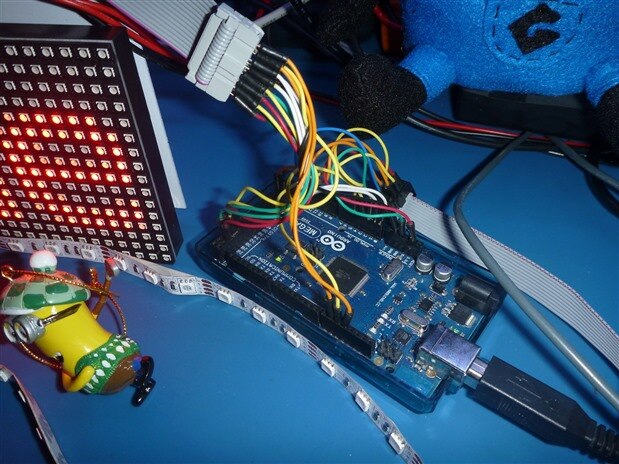

With an UNO you rapidly run out of pins too which is another good reason to use a MEGA, here are my attempts
the additional grey ribbon wire running off to the right on the mega is for the NRF24L01 radio
