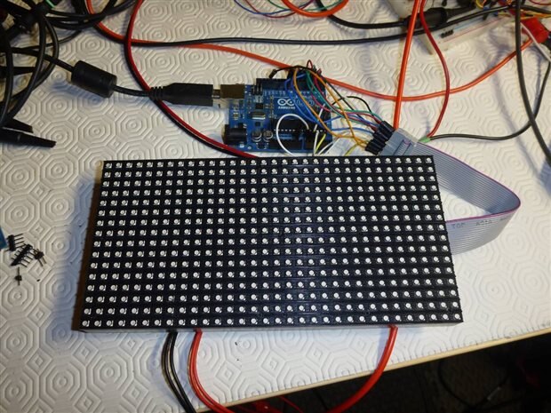

For today I have chosen to test out the 16*32 panels I bought from Adafruit, they arrived today image (yaaa, so many presents already ), these are not really meant for UNOs and the like, there really for massive street signs and ideally driven by powerful FPGA based systems but the great folks at adafruit have done a superb job of writing some libraries to allow them to be driven by even an UNO or a Mega with plenty of room to spare for other code, these displays have to be driven as a matrix actively by the UNO (There not neo pixels) so a fair percentage of cpu time needs to be used to scan the images onto the panel
This is what you get:
You can find all the code and wiring details here: http://www.adafruit.com/product/420 and believe me, these things are awesome, wire them up as instructed, apply power and a test sketch and it just works, It was even working before I connected the correct supply to the panel (Albeit a bit dimly)
My plan it to have Mr UNO or Mrs Yun drive this and possibly another to display web messages of cheer from a web site or twitter feed, may need moderation though or a menu of messages to select from, but for now I wanted to test how easy it is to use and send a holiday greeting to my companion competitors and eager followers
so here is the video of this working, and I have to say, these things are AWESOME

    It does support writing on it, it just takes all the memory etc, in the final solution I had to migrate to an Arduino MEGA in order to be able to add NRF Radio communications etc.

    It has basic functionality, I just went in and modified the demos, I intend to have 3 or more together soon
