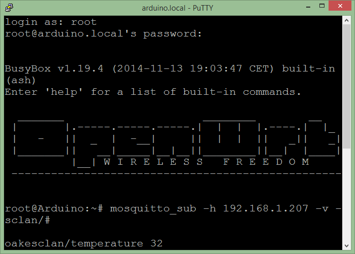

Given your successful you should be able to SSH into the Linux side of the board. I use a program called PUTTY (Down load from PuTTY: a free telnet/ssh client  ), the screen below show the start screen and how I configure it for my instance of a YUN. Saving the setting makes life so much easier later on
on connection you will be presented with a logon prompt, enter "root" for the logon name followed by "arduino" for the password
you should have a screen like the one below but without the mosquitto (MQTT) stuff at the bottom, note the date of the core version
BusyBox v1.19.4 (2014-11-13 19:03:47 CET), if yours is not at this level or newer, you may need to upgrade, I have two YUN's and one would work without upgrade, one would not, neither where at this date revision but all had the same version (v1.19.4) so I guess they don't update the version numbers for over a years worth of updates.so if things don't work and your not at this version, upgrade, it is very painless and I will have a video below (To Follow) to show how easy it is.
So once were here we can proceed to install the required software, this is available at the Mosquitto.org website "Mosquitto on OpenWrt | Mosquitto" simply follow the instructions
opkg update
opkg install mosquitto mosquitto-client libmosquitto
and your ready to roll, just type "mosquitto" at the command prompt and your broker is ready and running
here is the screen show of those steps
using the samples provided on the mosquitto MQTT site, it is easy to test the servers operation (See here: Documentation | Mosquitto )
once subscribers and publishers start to use the server, it will print messages on the console as shown below
I set up a raspberry pi with MQTT client and published a few events to the YUN as shown here, it also had a second console subscribed to only the humidity topic (Was on temperature to start with)
The YUN console subscribed to a wild card topic using "oakesclan/#" and received every publication as shown (# is a wild card for MQTT topics)
