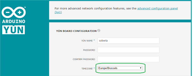

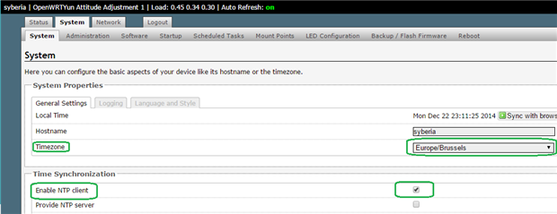

I've prepped my Arduino Yun to reflect the right date based on my timezone (Belgium).

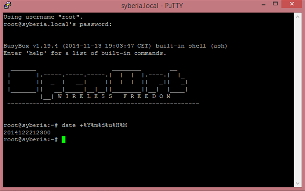

Then I refreshed my knowledge of the Linux date command.
I need the following parameters to get the data I need for my design:
       %d     day of month (e.g, 01)
       %H     hour (00..23)
       %m     month (01..12)
       %M     minute (00..59)
       %u     day of week (1..7); 1 is Monday
       %Y     year
Command that I'll submit in Linux: date +%Y%m%d%u%H%M
Result: 2014122212306

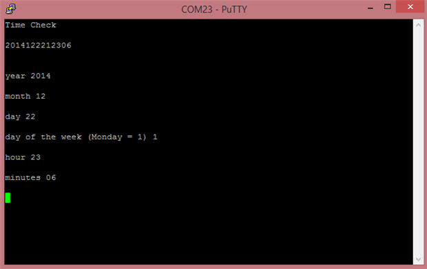

I used the Arduino.cc Time Check example as a starting point to get all info into the sketch.
That wasn't too difficult. Here's the result:
