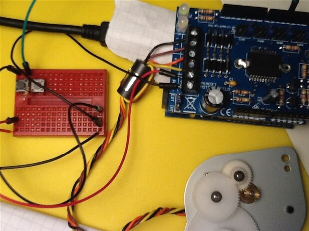

I have that motor working now.

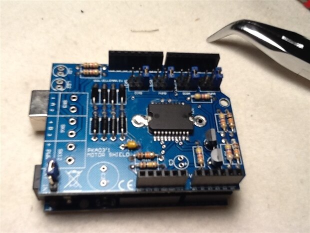

The motor driver kit

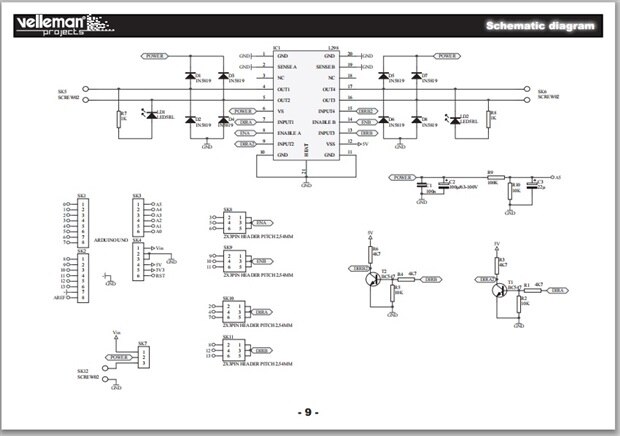

In my previous post I blogged about driving the motor with a 4 transistor H-bridge, and how I goofed that up. So I ended up dragging home a Velleman MOTOR & POWER SHIELD VOOR ARDUINO.
That shield's design is very similar to the Arduino Circuit for Bipolar Stepper Motor (the two pins example). Here's the two schematics side by side:
bipolar_stepper_two_pins2.png  image
Velleman and myself have one particular thing in common. We're both from Belgium.
The last time I've built a kit from them must have been somewhere in the late 80's. So I was quite excited to spend an evening of my Christmas holidays building up the kit.

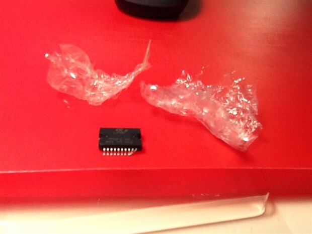

There was one unpleasant thingy though. The smd ic was packaged in bubble wrap with tape around it. And someone in the kit assembly department must have been too strong for that job:
No real harm done, I could straighten the pins without too much effort. Still, I'm expecting better...
Building the kit
That was not too difficult. There's only one smd component. In stead of soldering it with a fine tip pin by pin at the end - as advised by Velleman - I put that one up first.
I used solder paste and hot air. At my age, your eyes are happy that the don't have to stare at the 20 tiny pins while hand soldering each of them.

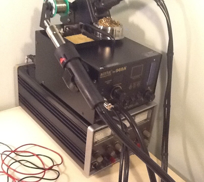

solder station
My solder station is an Aoyue 968A+. I've bought that with a voucher my company gave me earlier this year as a present. Because I'm a cheapskate, I searched for the lowest price (shipping included). That was on Amazon America.
The pleasant surprise came a week later when the Belgian tax authorities charged me an import tax that was lifting it way up above buying local. Go figure.
I'm rather fond on that solder station. Works well for me.
The other thing that I did different than Velleman's instructions is using flux. I'm soldering lead-free, and flux is more than welcome in that situation.
The kit is complete, and the instructions are easy to follow. And since it's been a while since I did that, it was quite an entertaining exercise.
The software
I want to use the Arduino Stepper library. In this contest, one of my goals is to stick close to the nature of the devices.
Since there isn't too much difference in design between Velleman's kit and Arduino's example, it shouldn't be too hard. And it isn't.
For the moment, I've left all the jumpers on my kit in their default position.

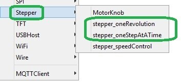

I've successfuly tested the following examples on my stepper motor / shield combination:
I haven't tried the other Stepper examples. I have no reason why they shouldn't work too.

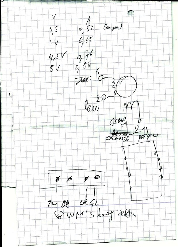

Motor and gearbox resolution
I've measured the motor resolution by adapting the stepper_oneRevolution example.
I found info on my motor (the Neocene 2T3542146) on the manufacturer's site. The step angle is 3,75°. 3,75°per Step = 96 steps per rotation.
I have verified that by running this adapted example:

    mcb1 over 11 years ago in reply to Jan Cumps +3
    Jan Cumps It is a TTL device, and yes not so static sensitive as CMOS devices, but still not a good practice. Selloptape generates thousands of volts and with quite a bit of energy (We measured it years…
    shabaz over 11 years ago in reply to mcb1 +3
    I agree. If it has semiconductor, personally I always place it into anti-static or static dissipative storage - and then it is one less thing to worry about. I also keep any empty card (for passives) or…
  • gadget.iom
    gadget.iom over 11 years ago +1
    An excellent article as always
    I agree. If it has semiconductor, personally I always place it into anti-static or static dissipative storage - and then it is one less thing to worry about. I also keep any empty card (for passives) or metal containers and save money : )
    A friend got me some wooden cigar boxes - I use them for capacitors : )
    Jan Cumps
    Selloptape generates thousands of volts and with quite a bit of energy (We measured it years ago but I can't recall the figure)
    The bent pins showed it either didn't protect it, or was damaged during packaging, so you have to ask why bother.?
    Nice.
    Jan Cumps over 11 years ago in reply to mcb1
    It seems that static isn't an issue for this paricular IC. The datasheet doesn't warn you like they do for sensitive components.
    Well done.
    Pity Mr Velleman doesn't understand about static electricity ...especially since they are an electronics company.  image
    Not only is the standard poly-bubble bad enough, but the act of pulling tape off a roll creates a HUGE static voltage.
