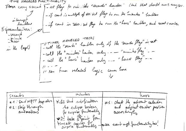

Why Time management
My wreath will be doing several things. A few of them event handled, other repetitive.
  • There are some animations happening (LEDs dimming and flashing)
  • A connection with the Eclipse MQTT broker needs to be kept alive.
  • I'm sending MQTT messages to something for surprise functionality on a regular base.
  • Others.
I can handle all of this in the loop() function without real issues (it's not that complex after all). But a timer can handle all of this without me having to worry about it too much.
The ATMega has spare timers, so why not.
In my design I need three granularities:
  • things to be done approx each second
  • actions that should be done each minute
  • hourly activities
So I've set up a counter that ticks every second and manages the cadence.

My interrupt handler does nothing more than marking what jobs need to execute:
ISR(TIMER1_COMPA_vect)          // timer compare interrupt service routine
  static unsigned int uSeconds = 0;
  uSeconds++; // every call is a second
  bRunSeconds = true; // so yes, flag that the seconds handler should be called
  bRunMinutes = ! (uSeconds % 60); // each 60th second, flag that the minutes handler should be called
  if (uSeconds > 3599) { // every hour
    bRunHours = true; // flag that the hours handler should be called
    uSeconds = 0; // and start over
This is a very short routine that is guaranteed to give back control to non-interrupt code fast
I have a function that calls the right schedule at the right times. That function is the first call in my 'arduino sketch' loop():
void loop()
  timerTasks();
  // non timer related functionality comes here
void timerTasks() {
  if (bRunSeconds && ! bIsRunningSeconds) { // timer interrupt flagged that seconds handler should be called
    runSeconds(); // but we only run it if it's not active
  if (bRunMinutes && ! bIsRunningMinutes) { // timer interrupt flagged that minutes handler should be called
    runMinutes(); // but we only run it if it's not active
  if (bRunHours && ! bIsRunningHours) { // timer interrupt flagged that hours handler should be called
    runHours(); // but we only run it if it's not active
As an example, here's some household variables, runSeconds() and the beginning of runMinutes():

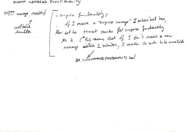

Why Event management
MQTT is event driven for the receiving side. You subscribe to a message, and provide the callback function that will be invoked upon incoming messages.
That is currently the only (non-interrupt) event driven scenario in my design.
Here's my handler. Some functionality that I'll reveal later is removed.
void messageArrived(MQTT::MessageData& md) // this handler is called when a subscribed MQTT message arrives
  MQTT::Message &message = md.message;
  // debug code
  sprintf(printbuf, "Message arrived: qos %d, retained %d, dup %d, packetid %d\n",
  message.qos, message.retained, message.dup, message.id);
  Serial.print(printbuf);
  sprintf(printbuf, "Payload %s\n", (char*)message.payload);
  // end debug code
  // in the real world, I should validate if this is the right topic -- I've only subscribed to one so I'll not bother
  // here be secret codes for surprise functionality
