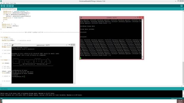

My entry for the Internet of Holiday Lights is an electro-mechanical wreath.
I am now working on the software part of the 'advent state' logic.
In my design, there is a bottom layer (the wreath) with 4 lights that represent advent candles. They are always on.
On top of that, I'm mounting a circle with holes (the 'light filter').  That filter can turn and is driven by a motor.
Depending on what week of the advent we are, one, two, three or all four of the candles have to be shown.
There are 23 states:
  • state 0: not an advent date
  • state 1: first Sunday of advent, show one candle
  • state 2: first Monday of the advent, still show one candle
  • state 8: second Sunday of the advent, show two candles
  • state 15: third Sunday, show three candles
  • state 22: fourth Sunday of the advent, and any day thereafter until January 6, show four candles
So I need logic to convert the day of advent into a particular position of the filter.
In one of my official posts on this contest, I have discussed my solution to get that date from the Yun's linux part.
And in that post, I was talking about intelligent solutions that would calculate the state for that day with nifty algorithms.
But now that I'm really implementing the solution, on a Sunday night after 12, the brain doesn't want to play along. So I resorted to a cheeky implementation:
  • I've hard-coded an array with advent days for the years 2014 and 2015
  • I've provided a second array with the corresponding states for each day in the advent
  • A lookup function that finds the correct state for any date within the covered period (let's call it the commercial guarantee period)
  • A function that looks up the day in linux and converts it to a long, in its own dodgy way
Below is the code. If you're looking for good code practices, this would be the right time to avert the eyes.

long getSysDate()
this function asks the Yun's linux part for the sysdate,a nd translates that to a long
retval: long - The current date as configured on the lini distro, just a conversion of the string YYYYMMDD converted to numerical
long getSysDate() {
  long lRetval = 0L;
  Process date;                 // process used to get the date
  Serial.println("invoking linux date");
  if (!date.running())  {
    date.begin("date");
    date.addParameter("+%Y%m%d");
    date.run();
  Serial.println("linux date invoked");
  while (date.available()>0) {
//    lRetval = date.readString().toFloat();
    String timeString = date.readString();
    Serial.println(timeString);
    lRetval = timeString.substring(0, 4).toInt() * 10000;
    lRetval += timeString.substring(4, 6).toInt() * 100;
    lRetval += timeString.substring(6, 8).toInt();
  Serial.println(lRetval);
  return lRetval;
int getAdventState(long day)
this function looks up the state of the advent. See comment section "Advent intelligence" above for the different states.
If the day passed to this function is found in the array adventIntelligenceKey, the corresponding state in array adventIntelligenceValue is returned.
Else we assume that we are not in the advent, and we return state 0.
The commercial guarantee of the gizmo powered by this algorithm should expire at the latest at the last day represented in the array above.
param day: the Long representation of a day to process, just a conversion of the string YYYYMMDD converted to numerical

So all high standards have been thrown out of the door, but the code works:
    mcb1 over 11 years ago +1
    So long as it works, nothing more can be expected. I see lots of code that is optimized/minimized to reduce size or run a little faster when there is no real benefit and its hard for others to follow.…
    So long as it works, nothing more can be expected. image
