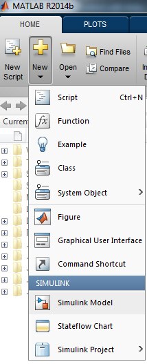

  • Create a blank Simulink model by clicking on 'New' on the MATLAB toolstrip and select Simulink Model.

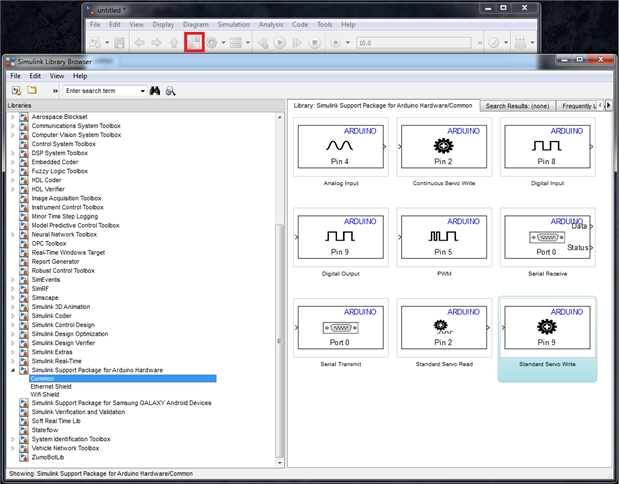

  • In the Simulink window, add the ‘Standard Servo Write’ block which is a part of the Simulink Support Package for Arduino Hardware. The path to the blocks is:
    Simulink Library Browser -> Simulink Support Package for Arduino Hardware -> Common -> Standard Servo Write

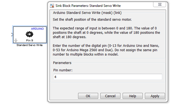

  • In the Simulink model, double click on the Standard Servo Write block and change the pin number to 4.

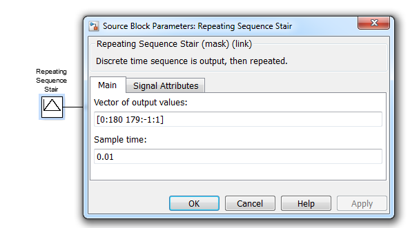

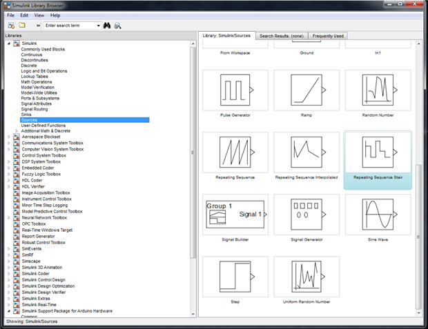

  • Similarly, insert the Repeating Sequence Stair block to the model, and connect the output of the Repeating Sequence Stair block to the input of the Standard Servo Write block.The Repeating Sequence Stair block can be found at the following path:
     Simulink Library Browser -> Simulink -> Sources -> Repeating Sequence Stair
  • Double click on the Repeating Sequence Stair block and set the sample time to 0.01. Change the vector of output values to the following : [1:180 179:-1:1]. The vector of output values is the input to the Standard Servo Write block and provides the angles by which the shaft of the servo motor should rotate. In this case, the shaft will rotate about 180 degrees in steps of 1 degree and then return to the original position.

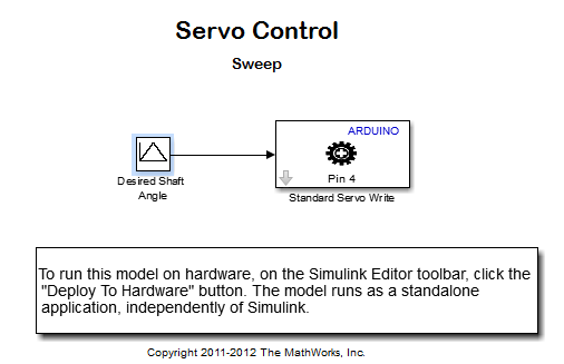

  • The final model will be the same as the example model named 'arduinomega2560_servocontrol_sweep.slx' which is an example model included with the Simulink Support Package for Arduino
  • Once the model is ready you can download the code onto your Arduino by clicking on the Deploy to Hardware button on the top right corner of the Simulink Window.
