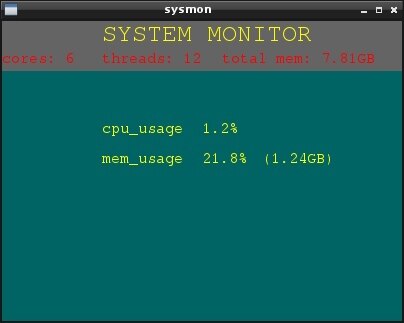

There seems to be plenty of LCD screen that fit onto the front of a desktop pc which display time, sometimes temperatures and fan speeds. I'm looking to expand on this and create an LCD screen that can be used to monitor the system performance such as memory and cpu usage.
The current LCD's take their data from temperature headers (some boards have them) and usually fan speeds directly from the fans themselves, to include system performance stats we need to be able to get that information out of the operating system and onto the LCD screen.
A great way of doing this would be through the serial (COM) header on the main board, most desktop computers don't have a physical serial port anymore but they do usually have a header on the main board. Since the LCD is to be mounted onto the front of the desktop case, we can connect directly to that header inside.
This is an overview of the system I have in mind:
Python script on PC >>> COM port >>> Arduino >>> LCD
An Arduino acts as the main system holding the drawing functions for the LCD. When the Arduino wants to refresh the data on the screen, it polls the COM  port which signals a Python script on the PC to collect the performance figures and send them back to the Arduino. The Arduino can then update the LCD.
It would be a great way for gamers, content producers and others who put their computer under heavy load to keep an eye on their systems performance.
I'm waiting on an LCD coming but have gotten on with the software aspect to test whether it is possible to get the information we need using Python. Since I don't have the LCD yet I used pygame to replicate it.
and a video of it in action...
Here is the Python script I used:

If you want to try it out remember to use pip to install pygame and psutil first
The next stage is to get the Arduino to communicate with this script through the COM port which I can get on with while waiting for the LCD to arrive image

    Is there a reason that you don’t want to use a USB port for communication? It would make the unit portable and wouldn’t require special connections.

    Ok, I understand.  I guess I never use up all my USB ports image.  Just thought it would be easier than doing the level conversion from the serial port.  Good luck with your project.

    Sure! The idea can easily be modified to run from USB and made portable its just not the goal I have in mind, I like the idea of having an LCD screen built into the computer case that has some ability to display and modify performance. With it being built in the screen would be on the outside of the case and the electrical connections on the inside so it would be advantageous to use the internal headers on the motherboard to send over signals.
    On mine and probably most other peoples desktop computer, all of the internal USB and USB3 headers are already in use and linked up to connectors on the case but the COM port generally never gets used and is pretty easy to use too, in the sense that its proposed I don't really see it as being a special connections since external sockets, power switches, drive lights all need to be connected to the motherboard in the same way. Its just another peripheral.
    Its a great question and a portable version would be just as great image
