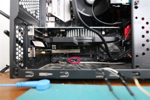

In the first part, I tested out Python to see if it was possible to gather some system information which worked very well. While waiting for the LCD screen to arrive I thought I'd try to see how straight forward it was to get that information out of a serial port.
I connected some hookup wires to the internal serial port of my Desktop PC:
And then used the following Python script to test:

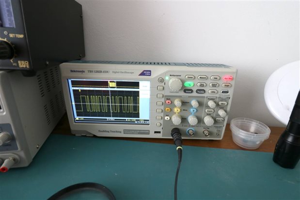

Just a very short script to open the port, send out the word "hello" and then close the port again. So I connected an oscilloscope to the hookup wires to monitor whether any signals were being sent when the script runs:
Awesome, the script works, the serial port works and there is a definite path to transfer system information to an Arduino which then display that onto and external LCD.
I was hoping to get some back and forth communication between the Python script and the Arduino happening but the oscilloscope suddenly reminded me of something I'd completely overlooked, it's been so long since working with serial ports that I'd forgotten that the desktop pc uses +/- 12V on its serial port and the Arduino uses 0V/5V ttl serial. Damn... I need order a level shifter before I can move onto that stage

    I ordered a bunch of Max3232 boards already populated even though I know full well that theres at least 2 Max232's in a dip package in my stores, theyre too cheap on ebay to be bothering with the soldering!
  • ralphjy
    ralphjy over 7 years ago
    Remember that RS232 also has the signals inverted so if you just do level shifting you'll need to account for the inversion in software.  If you use an RS232 interface IC like the Max3232 then it does the inversion as well as the level conversion.
