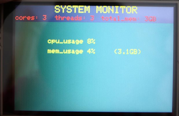

The LCD arrived so I got to work on writing an Arduino sketch, I decided to lay the LCD screen out similar to the Python test screen and this is what I ended up with:
The Arduino side of things is complete, It sends out a command over the serial port and waits to receive some data which it then updates onto the screen:

For the Arduino sketch, I kept everything in Arduino-ese. It was my first time ever using an Arduino and it was very easy to do although there are undoubtedly some code optimizations that can be done by replacing some of the Arduino-ese with C code.
The downside of using the Arduino is that its not the fastest runner in the world and takes a while to refresh the screen, from what I understand if I connected the screen in 8-bit mode to the Arduino then it would improve but maybe a future improvement would be to switch the Arduino out for something more capable, I bought a second screen so I can play about maybe on a raspberry pi.

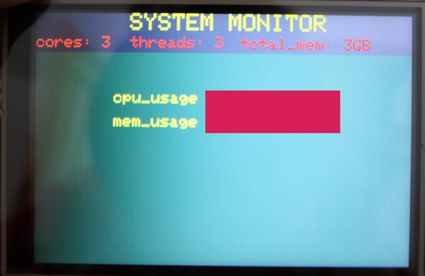

For the time being, rather ask the Arduino to update the full screen whenever a change is needed I just ask it to update the area's that are necessary. I did this by drawing a box the same colour as the background over the top of the text I was replacing and then redrawing the new text, the red box in the image below shows the area that gets redrawn with each update which gives it a much more realistic update speed.
