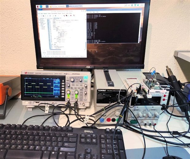

The components required are a Raspberry Pi and a microcontroller that can use the Arduino Wire Library and has GPIO, ADC, and PWM capability.  In the demonstration that follows a Raspberry Pi 4 and an Adafruit Feather M4 Express were used. Four resistors were used to make a simple resistor ladder to provide differing voltages for the ADC on the Feather.  A jumper was used to simulate a switch.   A closeup of the Raspberry Pi connected to the Feather with resistor ladder is shown below.

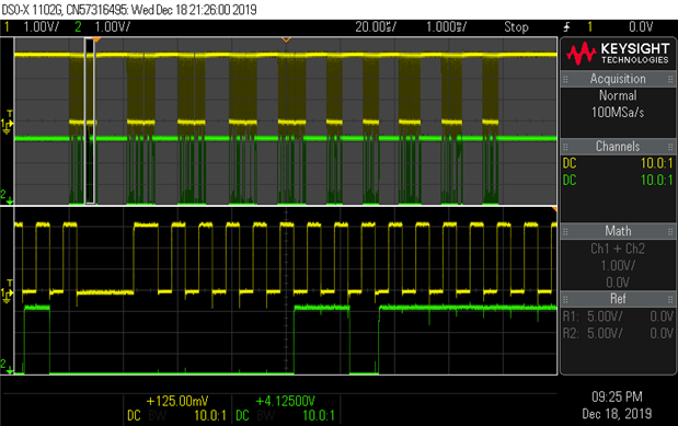

An oscilloscope was used to check that PWM and GPIO output were functioning as desired.  The complete setup is shown below.

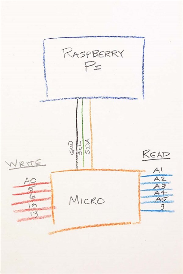

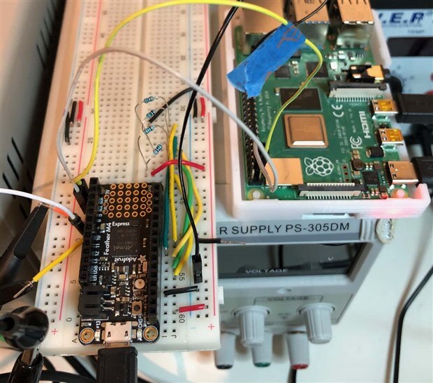

Adafruit Feather and Arduino Code
Connection between the Raspberry Pi and the Feather is as follows:
  • SDA <--> SDA
  • SCL <--> SCL
  • GND <--> GND
The following Arduino code can be expanded or reduced as desired and demonstrates GPIO, ADC, PWM, and transfer of data.   Note that code for controlling the DAC on the Feather is provided but it will not function properly if the other ADCs are being used.  You are free to use it as desired but keep in mind there is limited to no error checking and my intended use is as a hobbyist and not in critical applications.

Python Script
The rough Python script below can be used to test the microcontroller using I2C.
i2c_v1.py
Simple Python 3 script to test I2C
Tested on Raspberry Pi 4 B+ and Adafruit Feather M4 Express

The Python smbus module is easier to use than the Arduino libraries.  After instantiation of an object called bus on line 9 both reads and writes of any length (up to the maximum allowed 32 bytes) can be made.
The following snippet illustrates how to read:
      #2 Read A1
      offset = 2
      numBytes = 2
      block = bus.read_i2c_block_data(address, offset, numBytes)
      ADCvalue = (block[0]<<8) + block[1]
      Voltage = ADCvalue / 1023 * 3.3
  • The offset corresponds directly to the offset given in the C++ enumeration table given in the code for the Arduino
  • The variable numBytes is the number of bytes to read
  • The Python list named block contains the bytes to be read in using the function bus.read_i2c_block_data()
If there is only one byte being read in then just set numBytes to 1 and use the same code.  If necessary the bytes can be combined back into integers or other forms as shown in the example.
The following snippet illustrates how to write:
      #10 Write PWM
      PWM = int(PWMpercent / 100 * 255)
      msb = (PWM & 0xFF00)  >> 8
      lsb = PWM & 0xFF
      offset = 10
      data = [msb, lsb]
      bus.write_i2c_block_data(address, offset, data)
  • If necessary the information is broken into bytes, MSB first in these examples and placed into a Python list.
  • The data is written to the slave using the function bus.write_i2c_block_data().
If there is only one byte being written then the Python list need only contain one value.
More Thoughts on I2C
I2C has advantages - it can communicate between many devices, is simple to use, and requires only two pins in addition to ground.  It is not a particularly high speed protocol however and in this demonstration the communication is at 100 kHz.  There is overhead in that for every 8 bits of data sent one extra bit of meta data (an "ACK" or "NACK" bit) must also be sent.
I2C is "open drain" meaning that the bus can be pulled low but not driven high. The SDA and SCL lines require a pull-up resistor to pull the signal high.  In the example here the Arduino library and the Raspberry Pi make use of  internal pull-up resistors.  The Adafruit Feather is a 3V3 device as is the Raspberry Pi but there is a potential issue if the Arduino device is 5V.  In that case it is probably best to use a level shifter or at least not pull the voltage up above 3V3 for the sake of the Raspberry Pi.  The I2C bus is fairly robust but in the case of long connections higher pullup resistor values may cause issues and may fail entirely.  In this example 20 cm (8") jumpers between the two boards were used.  Out of curiosity, and since the oscilloscope was already hooked up, a screen shot was taken of the SDA and SCL lines.
The internal pullup resistors pull the signals back up to 3V3 sufficiently quickly and no glitches in transmission were observed.
