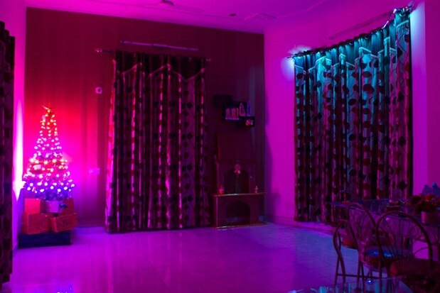

The Bigger picture
So its time to look at the final build. First a look at what was...
From that to...
and with only the curtain lights,
The Infineon RGB LED Shield Drives these and does a pretty good job too.(More in the Video in the next post.)
It is clear how both the light have a unique effect on their respective parts of the room. If both are combined in OpenHAB, the result is...
The blue cold adds a cold mood to the room which is what the mood lighting is supposed to do. Success! More than that, the sound and flickering lights combo create a Disco Mood and I have a video in the next post to show that.
I did not think that the curtain lights would be enough, but actually they work quite well. I am running them within limits so as not to damage them. Once the challenge has ended, I will further experiment with the shield's capabilities especially the DMX interface.
