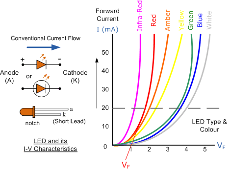

Just like a normal diode, we can plot the current and voltage characteristics of LED. I googled it and came up with the following.
http://www.electronics.dit.ie/staff/tscarff/DT089_Physical_Computing_1/LEDS/LED_Characteristics.gif
It is easily seen that after a certain voltage, as the voltage is increased, the current increases drastically. Larger current equal to a larger brightness change..This can also cause heat dissipation by
P = R x (I^2) = V x I

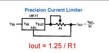

which means I can blow up my LED quite easily. I need a way to control the current through the LED and keep the current at a constant value. So how can I do that? The simplest way I have been making constant current sources has been the LM317 and the circuit looks like...
The 1.25 is due to the internal reference but I wont go into the details because the problem here is that this circuit is based on a linear regulator and is not very efficient nor does it offer digital control.

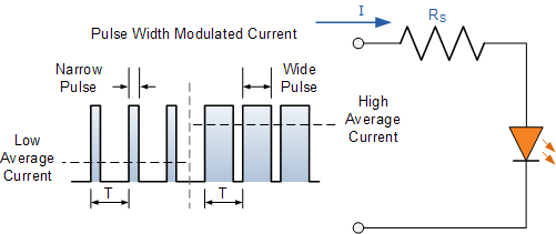

So how else can I control the current? The simple answer is PWM.
PWM Stands for Pulse Width Modulation and simply put, we switch the LED ON and OFF really quickly for a variable duration of time. The longer we switch it on, the longer the current flows and larger the average current and brighter the LED. Take a look at the image below.
(http://www.electronics-tutorials.ws/diode/diode44.gif)

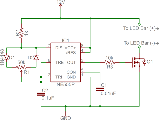

So my arduino can do that by default. There are PWM modules in built right? So whats wrong with that? Well you can switch the LED ON and OFF using the Arduino and you could probably do it using say a 555 in an astable mode too. I have used this circuit for some time now where I need variable brightness of the LEDs
For a circuit explanation see the video below
The problem with using the 555 is the switching speed. The slower the switching, the more prone to flicker in the LED. The second problem which is common with the arduino switcher is that we have no way of knowing what current is being drawn. Remember we need a constant current and if say one of the LEDs is shorted out, then we have no way of knowing about it and it might even damage the MOSFET. Yikes!

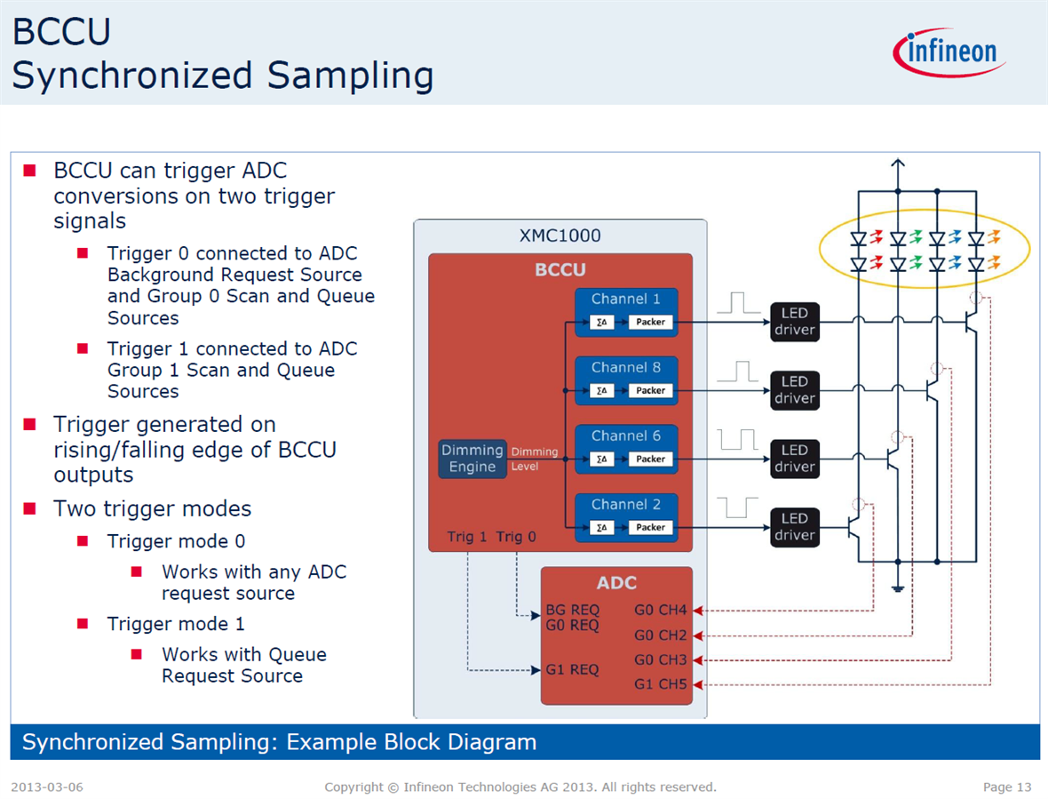

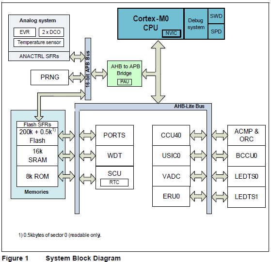

The XMC1202 is an ARM Cortex-M0 based micro-controller which has a dimming control peripheral for LED lighting applications, known as the Brightness and Colour Control Unit (BCCU). It contains 3 independent dimming engines and 9 independent Pulse Density Modulated (PDM) channels. 1 dimming engine and 6 channels are used in this shield.
What!?
Its an ARM Cortex-M0 core with some dedicate for control of LEDS and ADCs to measure the currents like I said before. The block diagram of the Chips is given below.
Whats the BCCU?
Take a look at this...
This is a slide from http://www.infineonic.org/download/index.php?act=down&id=4166 and is a presentation on the BCCU itself. The point here is that the ADC needs to sample current at the right time and needs to be fast enough. The XMC1202 can do a lot more as well but for people who just want to control the LEDs using an arduino, Infineon put the chip on a circuit, write a firmware on the processor and made it an I2C slave.

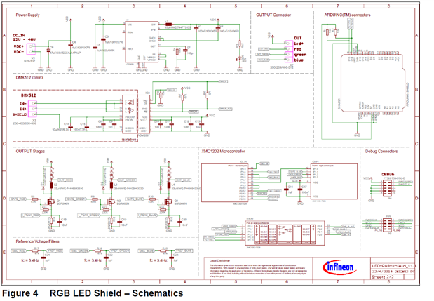

The RGB shield has the XMC1202 IC as well as the required circuitry to drive LED successfully. The circuit looks like...
Not much to talk about here. Its the same circuit I have discussed and the DMX section is something not mounted nor reviewed. What we can discuss is that the shield uses only 4 pins from the arduino which are voltage, GND, I2C_SCL and I2C_SDA and I can even drive this using my BusPirate. There is some ready code for the shield and I have attached the example code below.

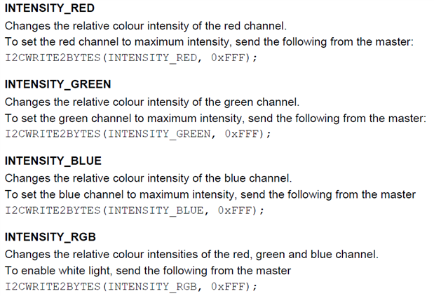

The user guide has a long table of commands that can be used to control the shield and the LEDs attached. We will take a look at a subset of the commands and how to use them. In order to send these commands to the shield we can write our own functions but the demo code has ready functions. These are essentially running the I2C peripheral on the Arduino so I will use them directly. There are a number of reasons why I want to do this.
Firstly, these are tested functions so it will reduce my prototying time. Secondly, I will probably wrap these functions in other functions which will have a more simplistic interface. In the days of C based network programming, I was taught to write these wrapper functions to reduce complexity but it has a second advantage. If I decide to change my platform to say a Launchpad, then I will write my own I2C driving code in Code Composer and wrap it with the same function as my arduino code. That way I dont need to modify my calling code and the transition becomes simpler. This is standard practice when writing protocols and I picked it up when I wrote my first MODBus Client on an 8051. Now I do this most of the time since I will change the platform at will depending upon the cost of the final product I am building and this means my code is reusable across products. image

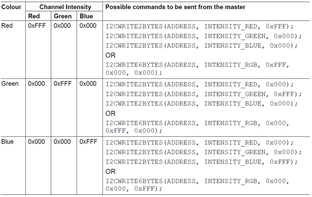

OK Back to the Commands. The first command is intensity which is intensity...
Simply put, the intensity is a 12 bit value which can be changed by calling ..

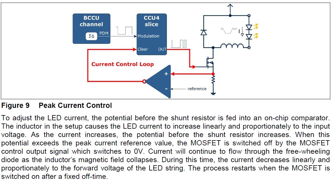

Peak Current Control.
This is important when you know your LEDs cannot handle more than a specific current. The system is as follows and is explained as well.
This is means I can set the max current by...

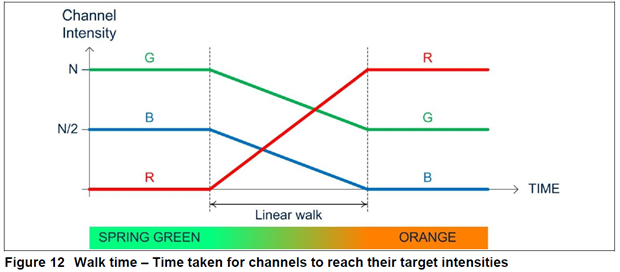

Another parameter is the Walk Time which is used to smoothly change the colour intensities. The intensities change linearly over time. Take a look.
