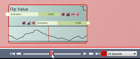

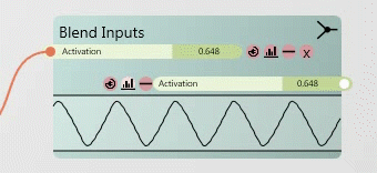

Has anyone seen or played wtih this visual, real-time development tool for Arduino programming yet?
Embrio - A visual, real time development tool for the Arduino
Program software for the Arduino in real time without writing code!
https://youtu.be/tiihsBPUkJ4
Kind of an interesting real time way to program.  Including waveform of the inputs and logic.
I just found it today.  Check it out!

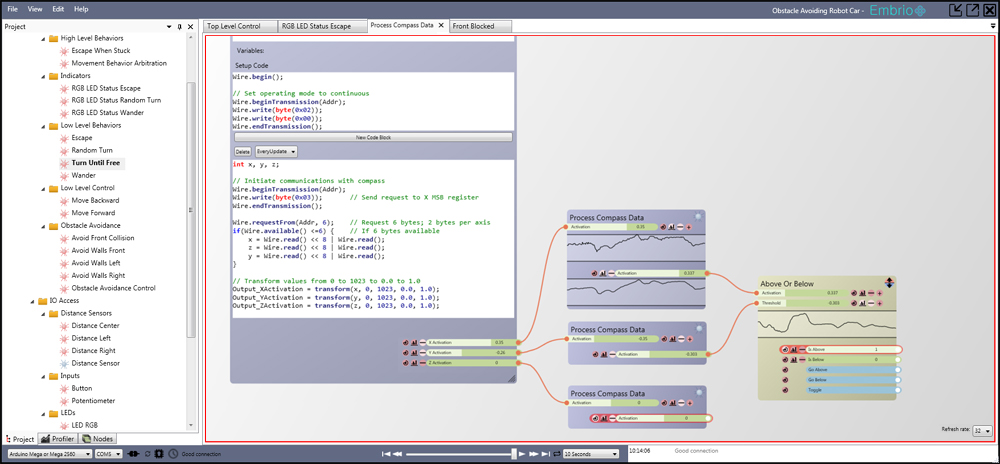

    I have gone through some of the tutorials and see what it was about. It takes Arduino code then cleans with encapsulated code formalizing inputs and outputs. This allows the blocks to be diagrammed visually…

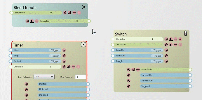

    I downloaded and tried the free version of  embrio - it's quite neat although you have to get into the way of thinking. I followed the tutorial to create the classic "Blink" program and it does work.
    However, there doesn't  seem to be a way of viewing the effective code and when you press the button to compile and download the code, it tells you that you need a full licence. So, is it worth it?
