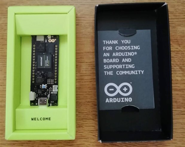

What's in the box?
There's not a lot in the box, just the Portenta board, a warranty note and tucked underneath an antenna that plugs into the UFL Connector for the Wifi and Bluetooth.

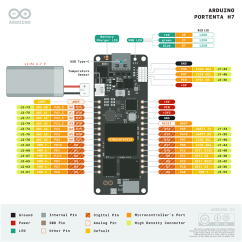

However, that does not mean you are not getting a good deal, the Portenta board is crammed with features:
There is a dual-core microcontroller (STM32H747) with built-in graphics capability, Wifi, Bluetooth 5.1, 2MB Flash, 1MB Ram, a security chip (NXP SE0502), LiPO battery charger, USB-C, a temperature sensor and an RGB LED.
Naturally, there's all the usual microcontroller capabilities such as PWM, ADC and DAC, Digital I/O, a number of timers and configurable serial comms including SPI, I2C, Uart and CAN.

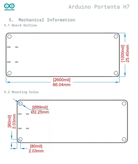

For me, one of the main features is the form-factor, same as the MKR boards and has mounting holes with space to fit bolts. Along with the MKR headers, there are 2 80 pin connectors, a battery connector (a 3-pin BM03B-ACHSS-GAN-TF), the USB-C connector and an ESLOV connector.

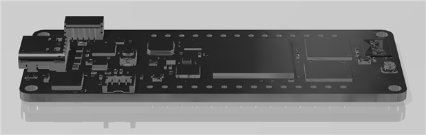

There are also a number of linked datasheets and an STL model for you to import into your CAD tool.

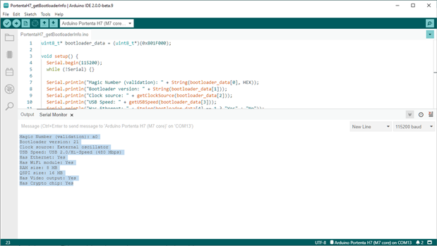

Firmware
The firmware is based on the MBed O/S and you can update that using a sketch or over the air. My bootloader was 21 and the current 22 so I've not updated that just yet.

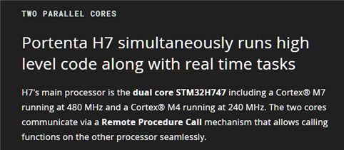

Dual Core
As mentioned above there are 2 cores in the Portenta. These run at 2 different speeds but otherwise are quite similar. There is a claim that these can talk via RPC but I've not tracked down the documentation for that yet. Also If you look at the blink sketches and tutorials there is a bootM4() command and without that running on the M7 core, the M4 core does not start.
