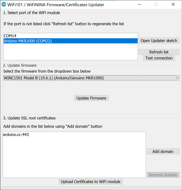

Updating firmware of MKR1000
since i do have MKR1000, i try the steps below on MKR1000 first
According to https://www.arduino.cc/en/Tutorial/FirmwareUpdater , we need to update the firmware
i have MKR1000, hence i try to update it first

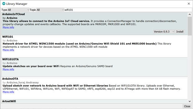

first, download the library wifi101

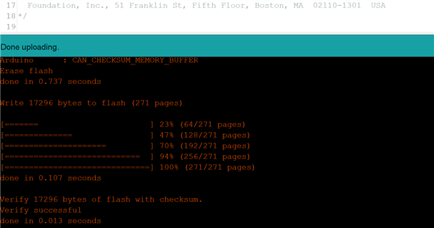

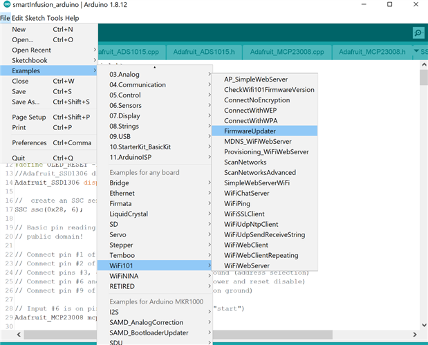

then load the sketch
once successful, the port number may reenumerate
then, update using the wifinina

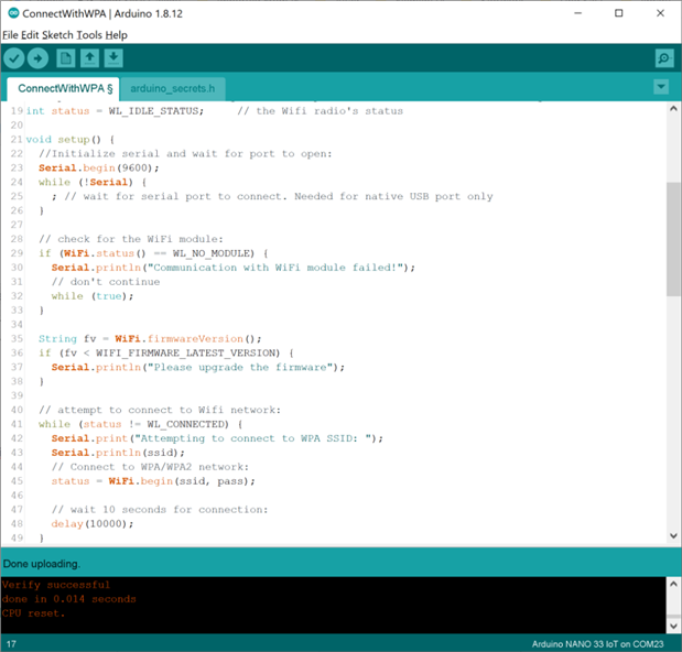

we make sure the board is working by running an example sketch
-ConnectWithWPA under Wifi101
in my attempt, it can't connect to 5GHz wifi. it only connect to 2.4GHz type
Setup Part 2
Now, we setup the Nano IoT 33
testing the same example sketch ConnectWithWPA under WiFiNina
similar to MKR1000, it can only connect to 2.4GHz type of WiFi

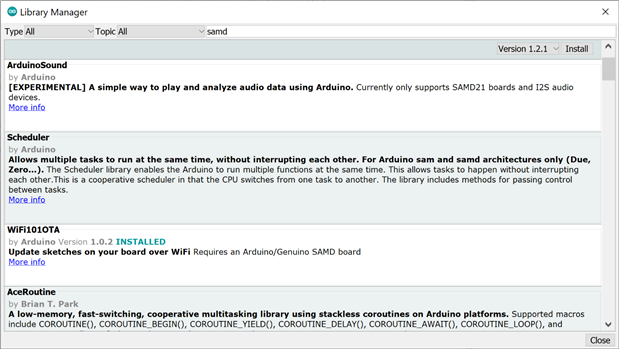

Misc Libraries Setup
during updating library, i saw this Scheduler . i decide to install it and keep for future reference

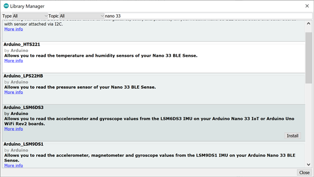

i also most likely need Arduino_LSM6DS3 to detect the accelerometer
Summary of #1 of Fridge Wizard Blog
is able to use the Nano 33 IoT to connect to home wifi network. However, only 2.4GHz wifi can be connected to. 5.0GHz is not connectable
