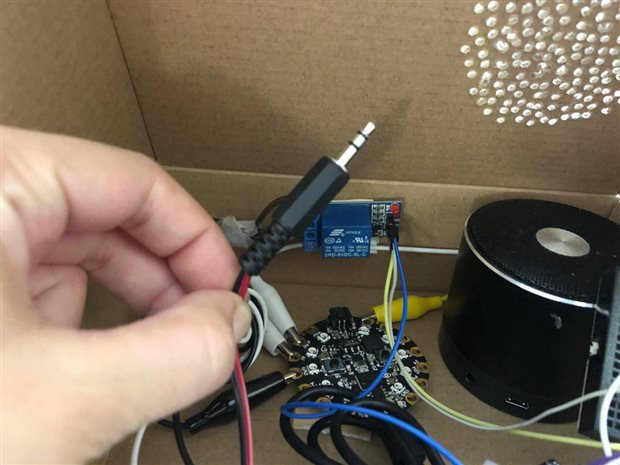

I first used Abraham's speaker with a differential amplifier but I thought it was not loud enough.
I remembered I had a small speaker with rechargeable battery so I decided to use it and a 3.5mm jack with the Circuit Playground Express.
Red cable to A0 pin con CPX and Black cable to GND

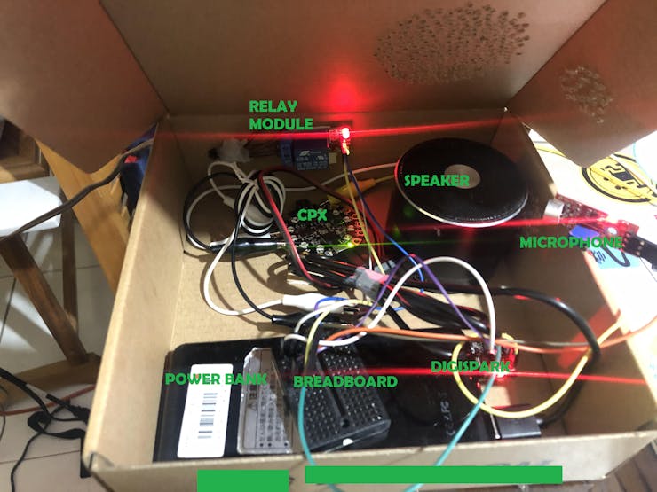

Since I had so little time, I decided to use a Digispark board and a generic audio sensor. A certain amount of noise would switch on/off the light bulb using a relay.
I used crocodile clips and Dupont cables so I didn't have to solder anything. The small breadboard was used to connect power and ground signals.
I put everything in a box and drilled holes for the speaker (a lot). The microphone had to be placed really close to the speaker.
Circuit playground Express and Digispark boards are powered with a 10,000mAh power bank with 2 ports, except for the speaker which had full charge.
Box with circuits
Put everything in a box

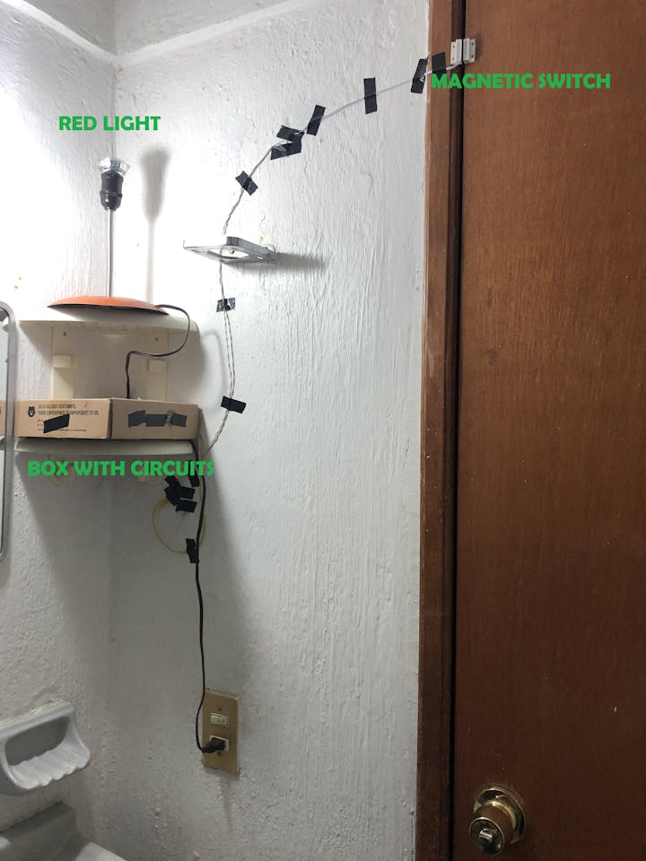

And the final setup:
Everything placed

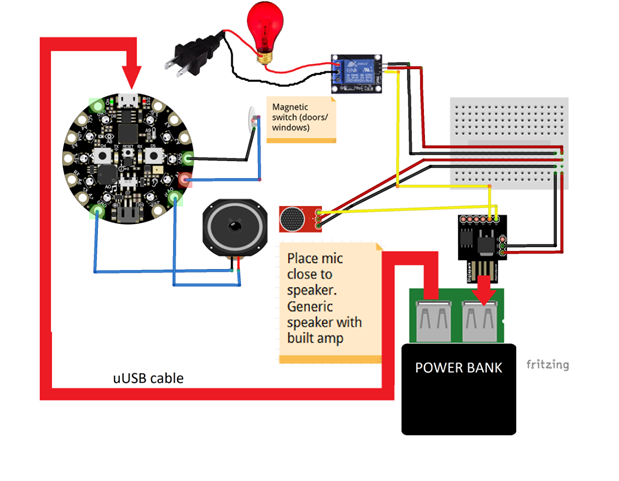

The basic wiring:
Diagram draft using fritzing and MS paint

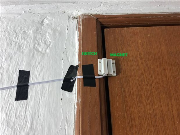

The switch is placed on the door frame and the magnet on the door, so when the door is closed the switch is also closed. In the previous image one of the switch pins is connected to ground, so the Circuit Playground Express will see a 0 on pin A1 when the door is closed.
Magnetic switch placement
When you open the door, the switch will open because it is not near the magnet and since pin A1 is declared with internal pull up, the Circuit Playground Express will see a 1.This is the Circuit Playground Express code:
