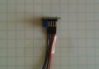

We are then ready to make a map of the magnetic field provided by a small magnet. The setup can be made as follows: just use a piece of scotch to firmly attach the sensor on a piece of graph paper, as seen in the picture below.
With the sensor in this position, the X-axis is perpendicular to the paper, the Y-axis  points toward left and the Z-axis points to the top of the figure.image

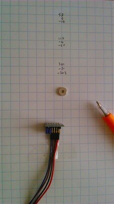

The picture shows how we proceeded: the metal ring you can see close to the sensor is a small neodymium magnet. The position of the magnet w.r.t. sensor can be obtained from the graph paper. For each position we read the three values of the field as provided by the sensor and write them down on the paper in the position occupied by the magnet.
In this way we can obtain a complete map of the field, measuring the values at different positions. Remember that the values provided by our sketch are now the readings in excess w.r.t. the earth's magnetic field, so we can get the magnetic field of the magnet directly from themimage
