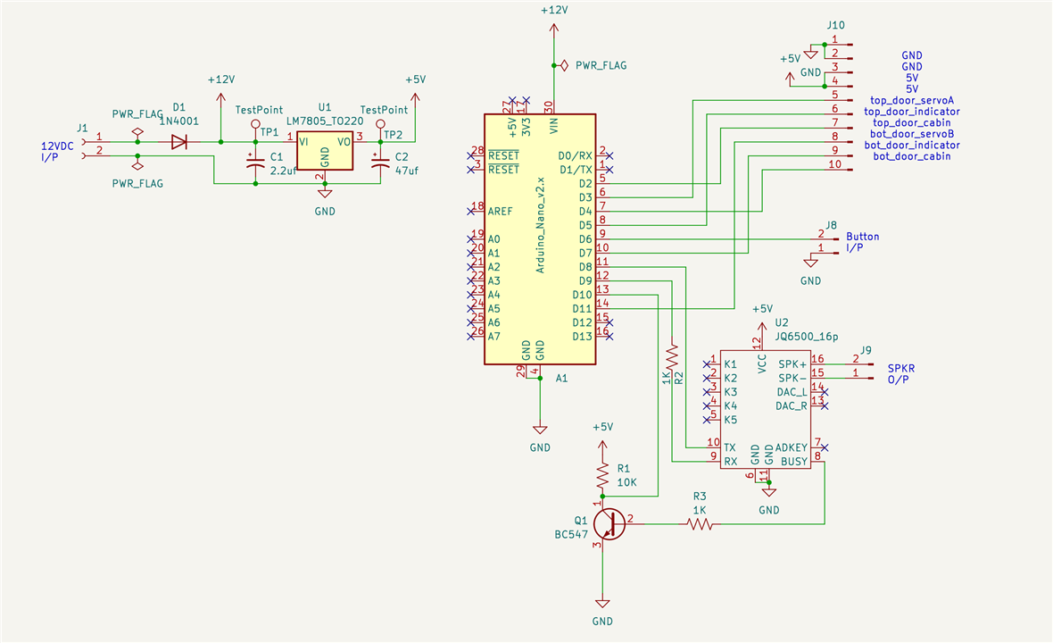

I trying to determine why the LED's on Pin 7 & 4 do not glow as bright as the pins on 5 & 2.
The nano circuit is for the two floor elevator project  Going Down anyone . I've generated a PCB and during testing, the LED for the bottom floor do not glow as bright as the LED for the top floor. I don't recall this on the bread board but then again I was so excited about 3D printing the servo assembly and making the frame I didn't pay close attention.
I've done the first steps of checking components and found no differences. If I cycle the LED's using bare minimum code there is no brightness difference. If I run top elevator code and bottom independently in their own code as a single door they work. Combine them into the code I created and they glow dimmer.

I'm taking the PCB to the shop to try adding a capacitor closer to the JQ6500 and the voltage output to the servo. Shabaz had recommended a capacitor for long runs the last time I had problems and it resolved them.
I confess I'm clutching here. The caps are for power that is not Nano related. LED's glowing dimmer is because of the Nano. I'm using a lot of pins. They are not on all at the same time to create an excessive load. I wish I was working to go for coffee with the tech folks. We would napkin out a solution for this in no time.
I was hoping some eyes on the circuit and code you might see "Oh yeah you failed to do this." Off to the shop to try the soldering iron.
  • beacon_dave
    beacon_dave over 1 year ago +2
    pinMode setup for the bottom elevator ?
  • JWx
    JWx over 1 year ago in reply to beacon_dave +1
    only two are configured as outputs: pinMode(top_elevator_Status_LED, OUTPUT); pinMode(top_elevator_Cabin_LED, OUTPUT); and the docs say: Pins configured as OUTPUT with pinMode() are said to be in…
    Jan Cumps over 1 year ago in reply to colporteur
    ...  telling me it took hours to find the issue and not just a mere "oh you missed the pimmode" on a cursory glance...
    That is not how the human brain works Slight smile
  • colporteur
    colporteur over 1 year ago in reply to beacon_dave
    BD, salve my programming ego by telling me it took hours to find the issue and not just a mere "oh you missed the pimmode" on a cursory glance. Your answer was what the sketch was missing.
    Confession: I wrote and tested the two elevator sketch, when the video was posted for the elevator construction. I put the code aside while the modeler caught up in the work to install the elevator in the main building. I also set about creating a PCB for the project because the elevator animation had grown into two animations in different parts of the building.
    It is July and I have the PCB's and the elevators are in the tower. Where is the code? It appears I did something in git and the code is no more. There is a one elevator sketch that doesn't work. The very beginning of the project. No working two-elevator code! How hard could it be the write it again? After a marathon code writing exercise I began testing using the PCB.
    I've been working on the project off an on for few a weeks to correct issues. The weak LED was one symptom the other intermittent operation of the sound board. Sometime it worked sometime not. I shelved the weak LED to look at the sound card (i.e. the power supply suggestions I made in my post).
    Your fix eliminated the intermittent sound issue and the LED brightness.
  • JWx
    and the docs say:
    are said to be in a low-impedance state. This means that they can provide a substantial amount of current to other circuits. ATmega pins can source (provide current) or sink (absorb current) up to 40 mA (milliamps) of current to other devices/circuits. This makes them useful for powering LEDs because LEDs typically use less than 40 mA. Loads greater than 40 mA (e.g. motors) will require a transistor or other interface circuitry.
    Pins configured as outputs can be damaged or destroyed if they are connected to either the ground or positive power rails.
  • kmikemoo
    kmikemoo over 1 year ago
    I didn't see anything in the code.
    Do the lower LEDs start out dim or are they bright then dim?  You may need to lengthen your delay to determine this.  Is the lower servo fed power or ground on a common conductor to the LEDs?  It could be a voltage drop issue.  I'm also wondering if you might have a "leaky" MOSFET.
    (I had a replacement generator controller once where OFF wasn't really OFF.  Enough current leaked through the MOSFETs that the generator would start as soon as battery power was applied to the controller.)
