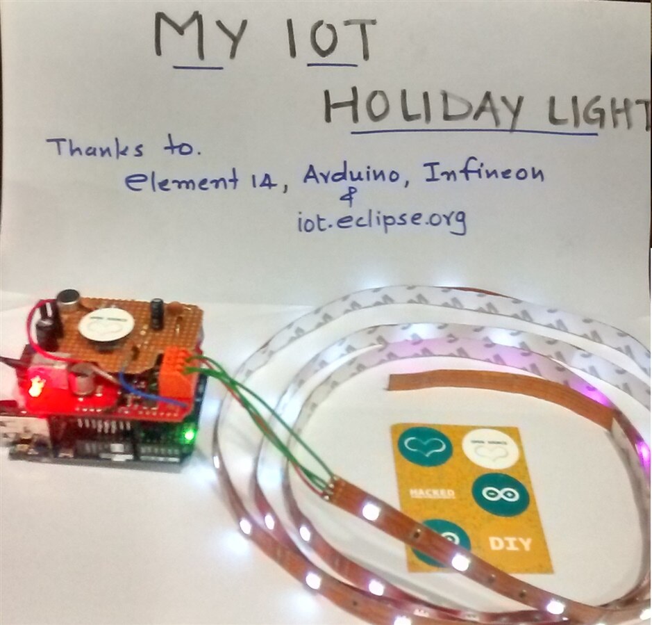

In this post and few upcoming post I will demonstrate my final build for "IoT Holiday Lighting Challenge".
I will explain step by step Android GUI Usage for My IoT Holiday Lighting here...
Main Funda for my project: Keep it Simple so all can do it without deep knowledge of embedded system and programming...
I have also kept BOM Limited... (Arduino yun, Infineon RGB LED Control Shield, RGB LED Strip, 12V 2AMP DC Supply, 5V 1AMP DC Supply and custom ckt for Music control lighting around TLV3402 Dual opamp and few passive components)
As I have used Rest style API for communication between App and Yun... There is no need for extra Hardware to setup broker and other stuff needed for Mqtt.
And by simple modification same application can be used with mqtt or CoAP...
So by using my simple setup LED lighting can be controlled from Local network or from Internet too...
Step By Step Demo Setup and Test
Here is my demo Setup..
And here are stp by step guide for Set up and run this Demo..

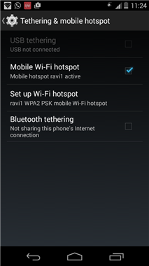

Step 1. Turn On Wifi Hot Spon on ur android phone (if You do not have WLAN Router near by.. like me)

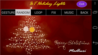

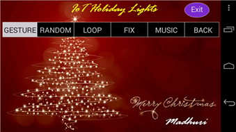

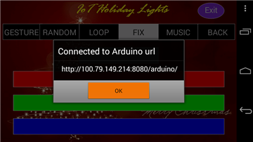

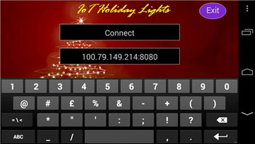

Step4: Update Ip Address by touching Ip address field then touch connect... At this step Android app is connected to yun ..

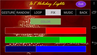

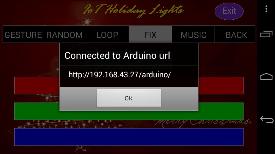

Step 6: move through options to see different LED Lighting Pattern... Play music for see music control lighting or Shake your phone to see gesture control lighting...

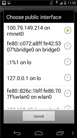

Step 7: If you want to connect your IoT Holiday Lighting to Internet simply do port forwarding on android phone..open Port Forwarder.. Select Public interface (IP given by your network operator), forward 8080 port from public Interface to 80 port of your Yun.. and start port forwarder.. Cheers.. Ur Yun is now on Internet...
