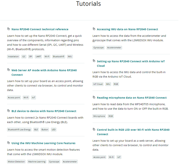

Perfect time to check out how things have changed by looking at the Nano RP2040 Connect docs.
I like the new organization and layout, it's easy to jump right in and get started.
The Tutorials section is really nice in that it showcases a lot of the board features.

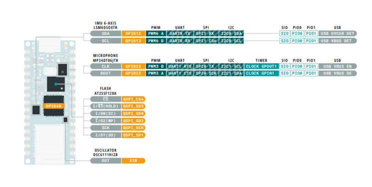

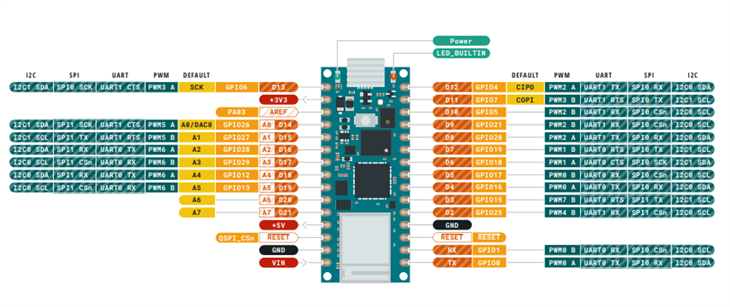

Another feature that I also appreciated is the Full Pinout document that has 6 different pinout diagrams that save you from having to decipher variant.h files.
One shows how the multiplexed IO resources are assigned:
And another one that is really helpful, shows how the onboard peripherals are connected:

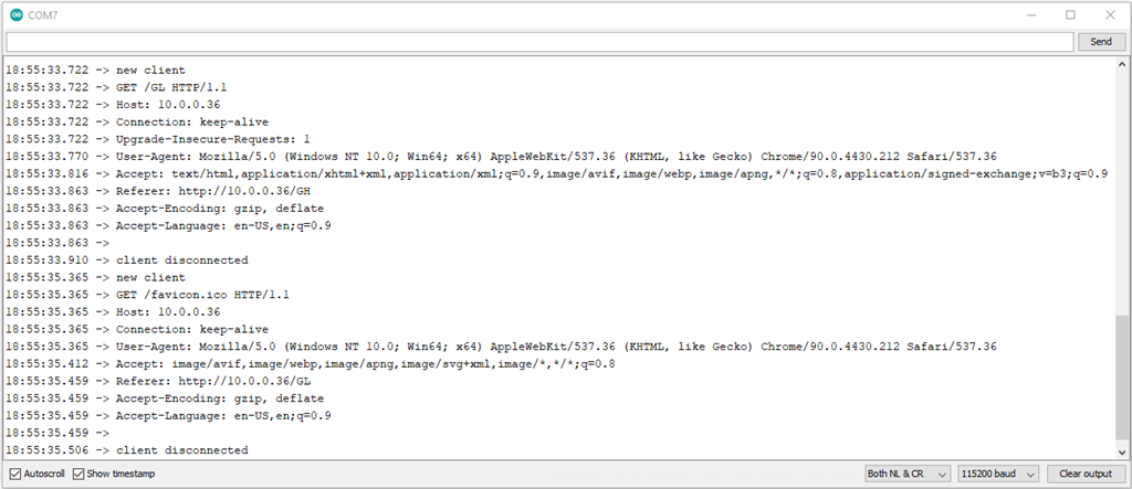

A short video of it working:
And the Serial Monitor output showing the HTTP transactions:
